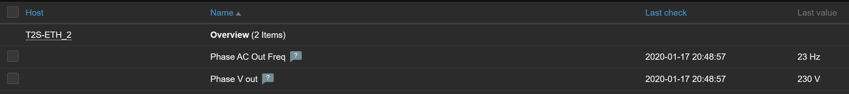

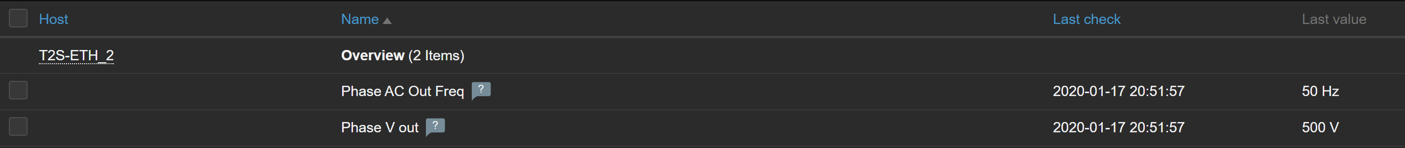

    I made a template for some power inverters with SNMP v1. I created a few hosts too. But, the latest value shows the same value for all items... I have other templates with other hosts and all of them work just fine.
    Here is a screenshot:
    Click image for larger version  Name:	img2.png Views:	4 Size:	41.7 KB ID:	393574
    and after 30 sec (update time) it looks like this:
    Click image for larger version  Name:	img1.png Views:	4 Size:	42.4 KB ID:	393573
    The expected value for the first item is 50Hz and the second item is 230 or 231 Volts (first is gathered in tenth of Hz so it has multiplier '0.1').
    If someone has an idea or experience with these, that would be very useful for me.

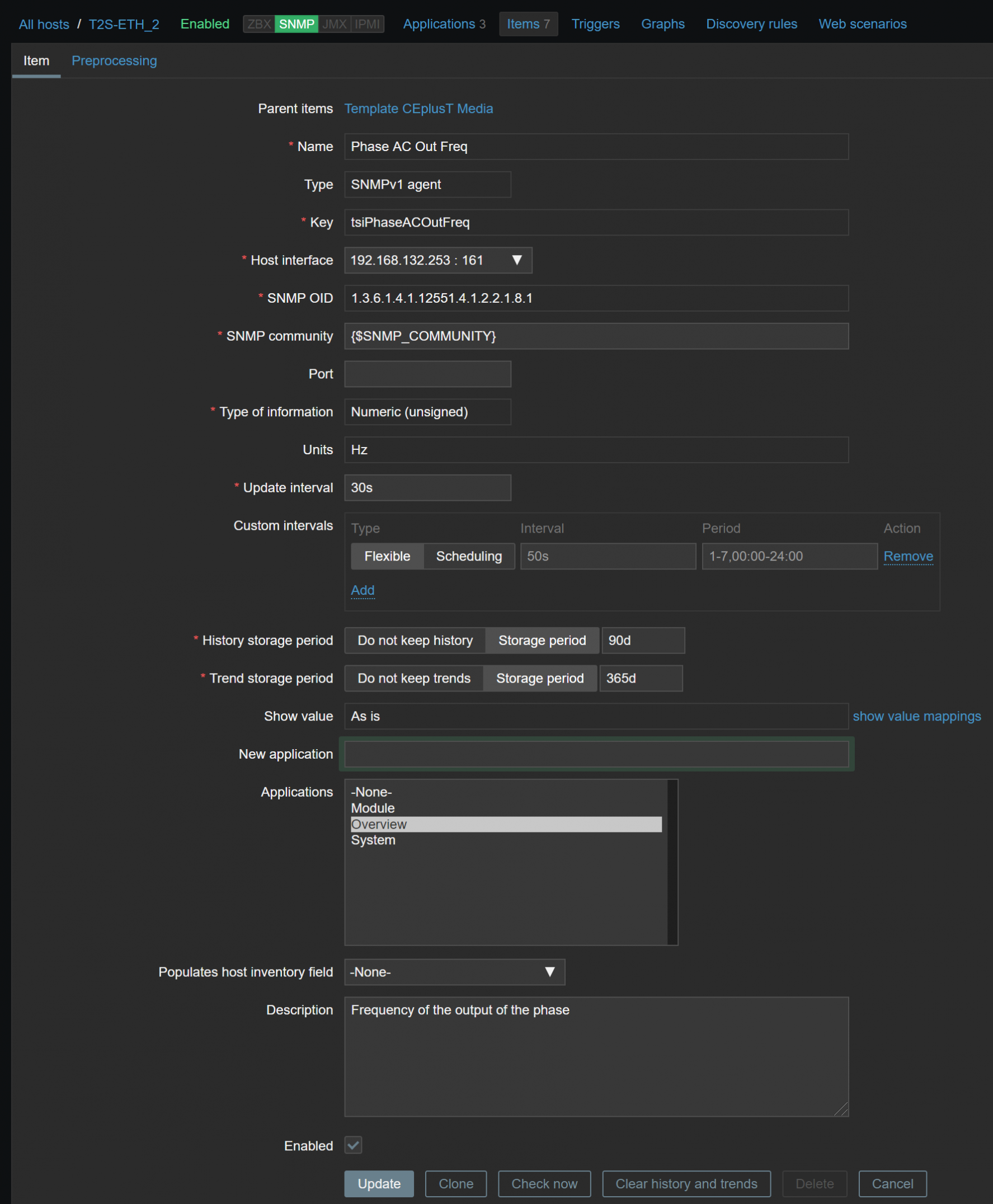

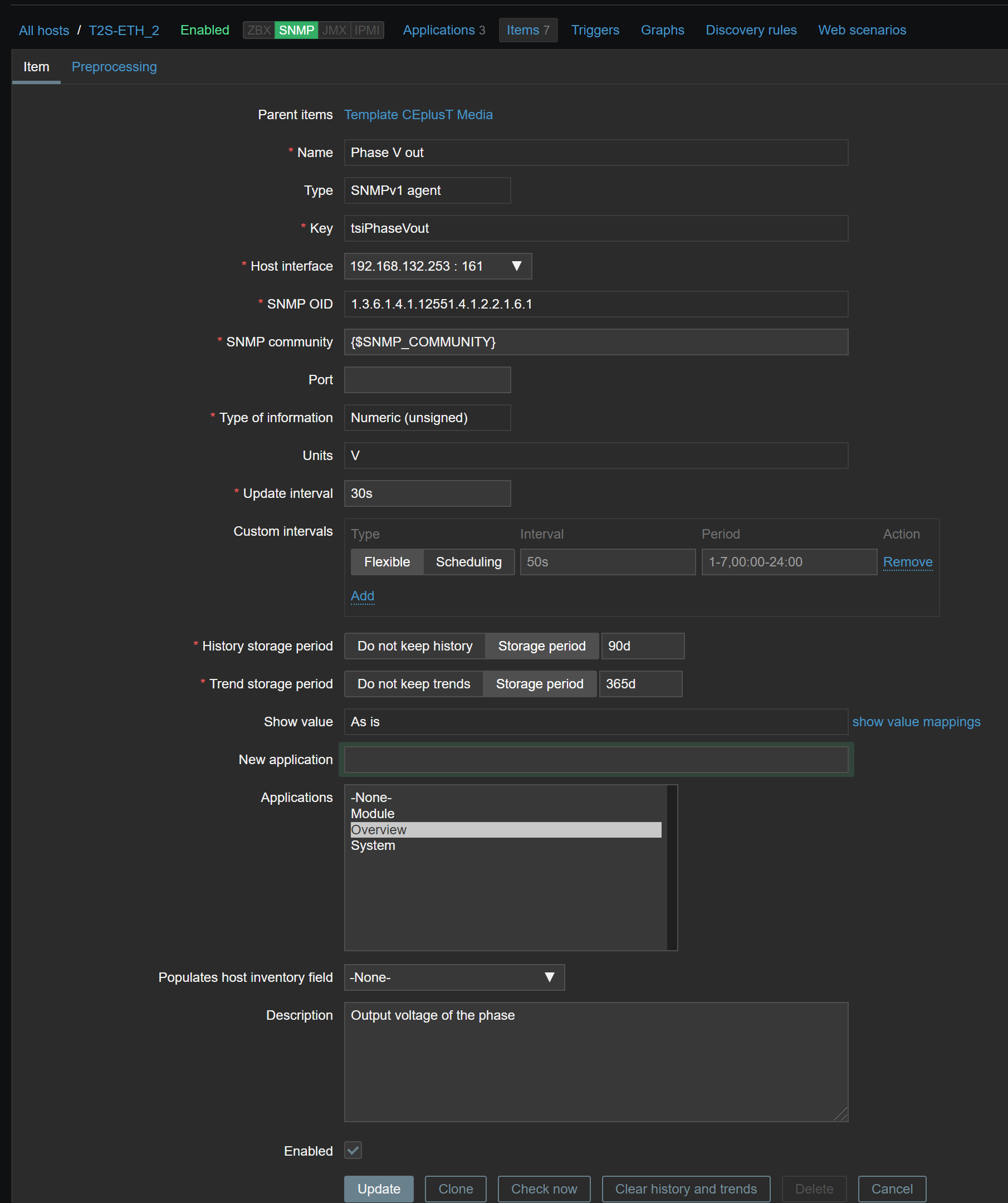

    Item looks like this:
    and:
  • 1berto
    • Sep 2018
    • 182
    Post your item definitions...
    • knez
      • Dec 2019
      • 44
      I edited post... there they are... thanks...

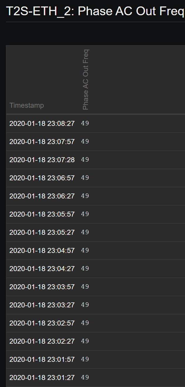

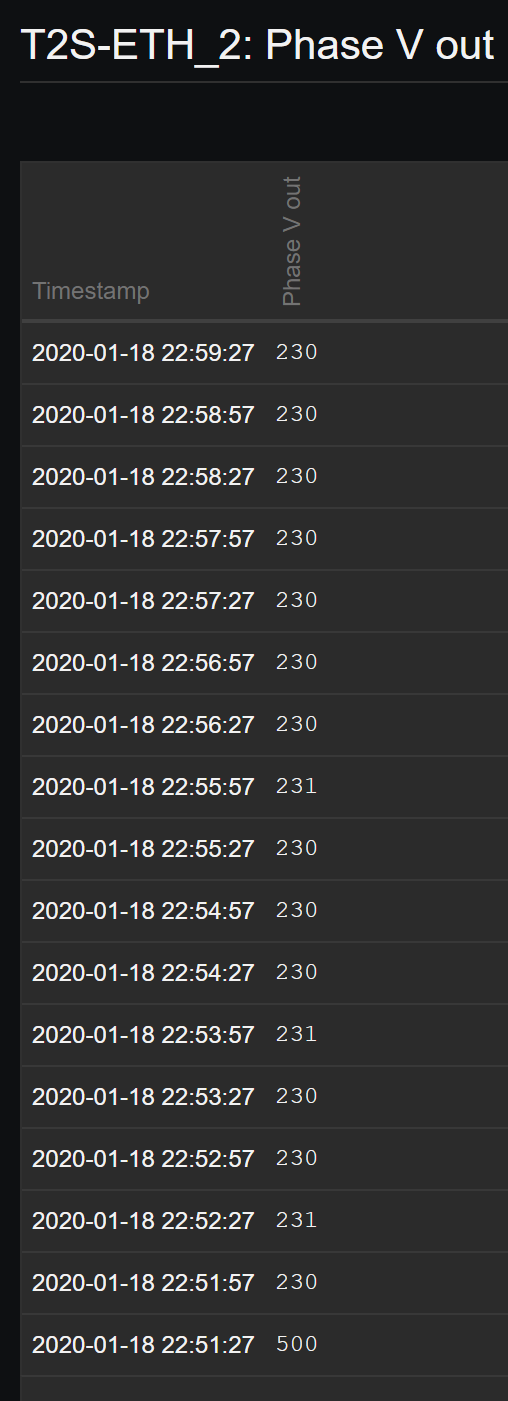

          Here are the values from the last 18 timestamp:
          Timestamp Phase AC Out Freq (multiplied by 0.1) Phase V out
          18.1.2020 13:18 50 500
          18.1.2020 13:18 23 230
          18.1.2020 13:17 50 500
          18.1.2020 13:17 23 230
          18.1.2020 13:16 23 230
          18.1.2020 13:15 23 230
          18.1.2020 13:15 49 499
          18.1.2020 13:14 50 500
          18.1.2020 13:14 49 499
          18.1.2020 13:13 23 231
          18.1.2020 13:13 49 499
          18.1.2020 13:12 23 230
          18.1.2020 13:12 49 499
          18.1.2020 13:11 49 499
          18.1.2020 13:10 49 499
          18.1.2020 13:10 23 230

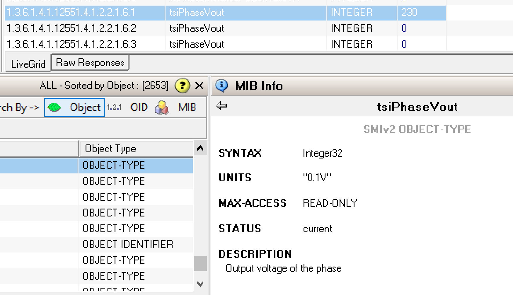

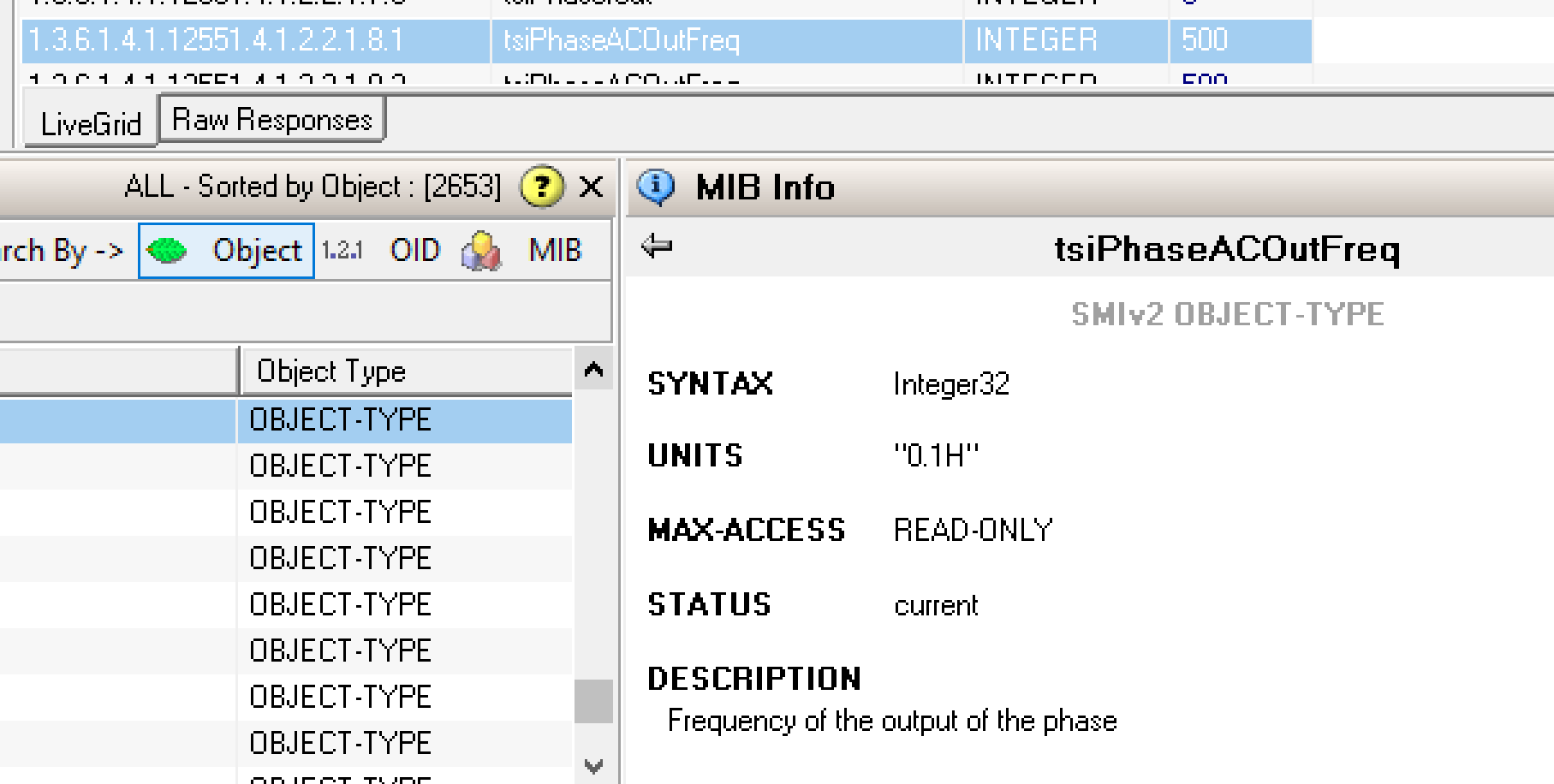

          OID's:
          OID Object Type Values read by app OiDViEWFREE and expected too Decription Units
          1.3.6.1.4.1.12551.4.1.2.2.1.6.1 tsiPhaseVout INTEGER 230 Frequency of the output of the phase 0.1 Hz
          1.3.6.1.4.1.12551.4.1.2.2.1.8.1 tsiPhaseACOutFreq INTEGER 500 Output voltage of the phase V

            Ok, so each OID returns randomly the voltage or the frequency value, that seems very odd. And the documentation is off too: tsiPhaseVout has description of frequency, and vice versa. (Kind of logical: everything is messed up )
            I would first make sure that I request only one of those values, for example just the voltage, from the device, and see if that makes any difference (= if the random values continue or not). And I would try to repeat this random behaviour with simple snmpwalk commands so that the product vendor could be contacted with a bug report. Firmware upgrade for the device could make a difference.
              this is my mistake.. sorry.. it is a correct description in OID table:
ID:	393612 Click image for larger version
              I tried with snmpget and snmpwalk and values are always correct and expected. This app "OiDViEWFREE" show values correct too.

                Btw in the screenshot the tsiPhaseVout units are said to be 0.1 V, meaning that raw number 230 would mean 23.0 V...
                Markku
                • Markku
                  • Sep 2018
                  • 1784
                  MIB can be found in: http://www.acbackuptsi.com/doc/MIB/CET-TSI-MIB.mib
                  It says:
                          --OID : .1.3.6.1.4.1.12551.4.1.2.2.1.6
                          tsiPhaseVout OBJECT-TYPE
                        SYNTAX                                            Integer32
                        UNITS                                                "0.1V"
                        MAX-ACCESS                                    read-only
                        STATUS                                            current
                        DESCRIPTION                                    "Output voltage of the phase"
                          --OID : .1.3.6.1.4.1.12551.4.1.2.2.1.8
                          tsiPhaseACOutFreq   OBJECT-TYPE
                        SYNTAX                                            Integer32
                        UNITS                                                "0.1Hz"
                        STATUS                                            current
                        DESCRIPTION                                    "Frequency of the output of the phase"
                  Have you tried in snmpwalk and in Zabbix without the .1 at the end of the OID in the item configurations? I'm not totally sure about the exact syntax there.

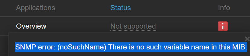

                    That "0.1Hz" is a vendor mistake ... it is just "Hz", actually.
                    When OID 1 is disabled and OID 2 enabled and vice versa I got correct values ​​...
                    • knez
                      • Dec 2019
                      • 44
                      Have you tried in snmpwalk and in Zabbix without .1?
                      I did:
