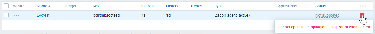

                Sorry I have to ask this to be sure as you didn't show the full configuration: In your latest test you created a new log item, did you select the item type "Zabbix agent (active)"?
                This is how it looks like if Zabbix agent cannot access the file:
                There is also error in zabbix_agentd.log:
                31342:20200206:155427.313 active check "log[/tmp/logtest]" is not supported: Cannot open file "/tmp/logtest": [13] Permission denied
                People are always talking about SElinux problems, I don't know about those, maybe worth trying disabling it for testing if in use.
                Re-read the manual in https://www.zabbix.com/documentation...ypes/log_items, if that gives you some idea. Otherwise I don't have new ideas. Some difference there apparently is if you say that one of the two identical items doesn't work.
