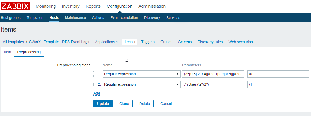

    New to Zabbix but picking up steam quickly. Here's the question:
    I'm monitoring a Windows Event Log and it's coming in fine, but I on;y need 3 pieces of info from it and want to create 'fields' with those pieces of information by extracting them from the log with a regex so that they can be shown in a table in Grafana later.

    The info in bold are the pieces I want to extract using item preprocessing with a regex - I have the regex's written and working in regex101.
    Using the info from the event above I posted - here's how it looks when I test:
    When I put 1 regex like this I get the expected data back as DOMAIN\username:

    But when I put them together - the 2nd one ALWAYS fails. What I 'think' is happening is that the regex extracts the first value and attemts to extract the next regex from step 1 instead of the event in the event log. Which is not how I'd expect it to work. See screenshots:

    Can anyone explain to me if I'm doing something wrong or misunderstanding preprocessing? I'd expect to get the Username and Password exacted as part of the event and then be able to work with those 2 fields in Grafana for the event is my end game.

      Hi, so we are talking about configuring an item here. That's just that, *an* item, you cannot store two pieces of data in one item.
      Maybe use one item for the full data and then use two dependent items to parse the required fields from the master item. That's how I parse a complex MariaDB status output: one item grabs the data, and several dependent items parse that data one status item each.
      The dependent items are evaluated every time the master item changes.
