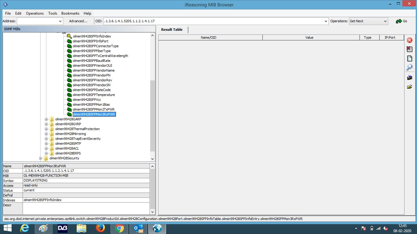

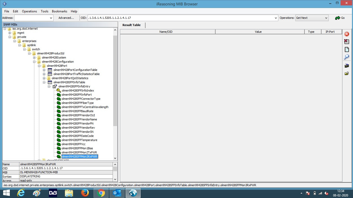

      using Zabbix for the first time
      have the OID info for sfp info table (screenshot attached)
      switch : Optilink OL MEN 99428
      need help to create template that will show sfp info(Rx Power) in dBm in Map besides(Element name) and need to set trigger if power goes above or below certain values

          You can add the filter and the map later, but start by creating a template with the SNMP item you want to collect. SNMP items are covered in the Zabbix SNMP agent item documentation.
          If your Zabbix server install has imported the default set of templates, there are probably some examples you can look at in those templates.
          Once you have data collection (the item) working, then you can add triggers based on the data, but you need to start by getting data collection working.
