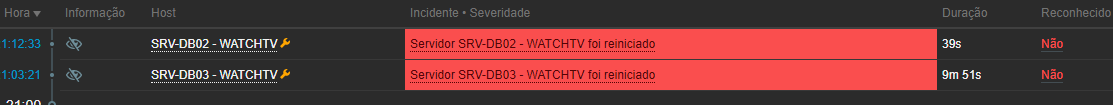

    Good evening! I am experiencing problems with reboot false positives. All servers are triggering the reboot trigger, when in fact the host is up. What can it be?
    Alert
    Trigger
    Detail: Uptime of the server informs that the last reboot was 9 days ago.

    Hi, what is your item interval?
    The "change(0)<600" trigger will activate if your uptime item interval is shorter that 10 minutes.
    And, once it is activated (in reboot as well) it only deactivates if the interval is longer than 800 seconds...

      Usually the uptime trigger change(0)<0 is used, to detect if uptime counter went to zero.
