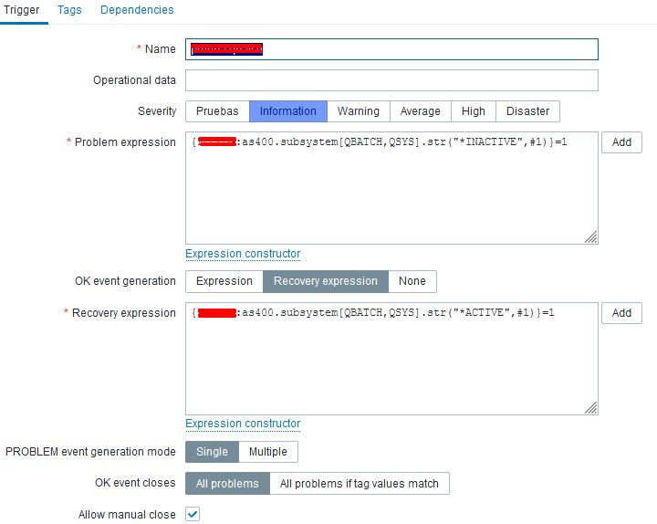

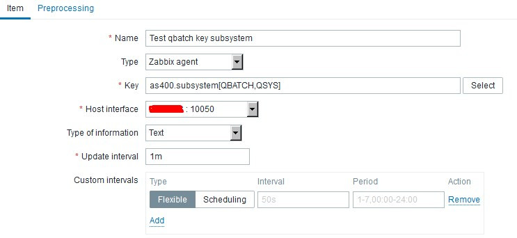

          Try these triggers:
          Trigger Expression:
          {LPAR1: as400.subsystem [QBATCH, QSYS] .str ("* INACTIVE", # 1)} = 1
          Recovery Expression:
          {LPAR1: as400.subsystem [QBATCH, QSYS] .str ("* ACTIVE", # 1)} = 1
          This monitoring must be text type.

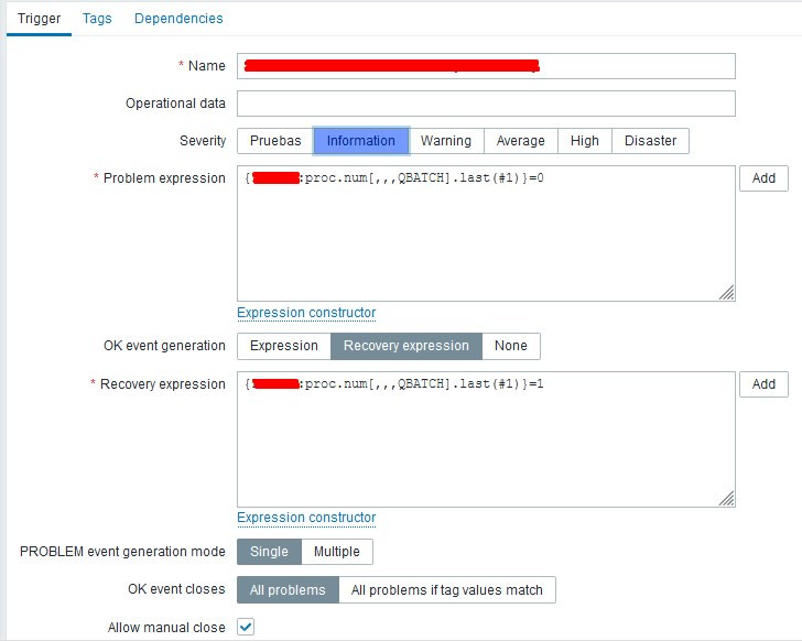

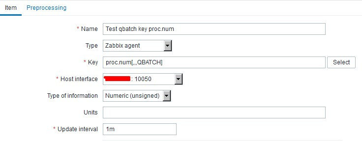

          I monitor the subsystems with the key proc.num [name, user, state, subsystem]
          With which I can see if the subsystem is booted and the amount of jobs it has.
          For example, in your case the key would be something like this:
          proc.num [,,, QBATCH]
          It will give you a numerical value, if it is 0 it means that it is not started, so the trigger would be something like this:
          Trigger Expression:
          {LPAR1: proc.num [,,, QBATCH] .last (# 1)} = 0
          {LPAR1: proc.num [,,, QBATCH] .last (# 1)} = 1
          I hope it helps you.
          • bigredau15
            • Aug 2020
            #140
            Thanks for the assistance, unfortunately both methods failed to work. I must be doing something wrong.
            Is there a possibility for you to take some screenshots of the Item and Trigger page that you've got configured?
            Thanks again

              #141
              Hi bigredau15
              Item and trigger key subsystem:
Name:	item key subsystem.jpg
Name:	Trigger key subsystem.jpg
              Item and trigger key proc.num:
Name:	item key procnum.jpg
Name:	Trigger key procnum.jpg
              Tell me if this helps you.
              • bigredau15
                • Aug 2020
                #142
                Thanks Sancho!
                The proc.num method worked - but I have no idea what I did differently today that I did yesterday (when it didn't work)! Either way, thank you for all of your help.

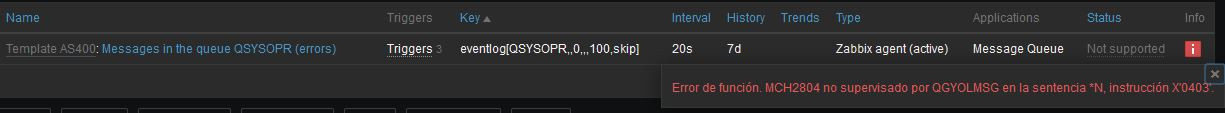

                        Hi Kos! I am using your agent for almost 2 years and its been a great asset for me. Thanks for that! Anyways, I am having trouble with active check message queue items with the eventlog . They were working fine until a couple of weeks ago when suddenly items started to get to a not supported status reporting an MCH2804 not supervised for QGYOLMSG. I read a couple of notes saying that the app is not closing the lists after reading the message queue. I restarted the agent, even upgraded the ZabbixAgent.jar to the latest version but nothing seems to work. I get the messages but keep getting them 5 to 10 minutes after i should.
                        I saw on your readme that you already fixed this bug in an earlier version of the agent, Could you help me? Thanks!!

                          Hi camiespico,
                          according to IBM documentation, this error message really does mean that some list of objects (most probably, a list of messages in the message queue) is regularly not closed. However, it seems that this list is closed correctly by our Agent every time.
                          Could you like, please, send me a log file of the Agent emulator onto my e-mail mentioned in the README?
                          This log file should include messages, at least, from the last agent start, and up to the moment when the problem is occurred.

                              Hi, I also see this error on a single partition. Any idea how I can get it to become supported again? I have gone through agent log, joblogs and similar, but I cannot find any errors relating to this error.
