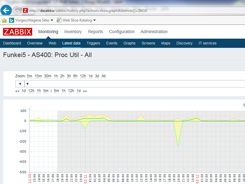

    It is a interesting effect about negative values for CPU utilization. I didn't see that; but I'll check this moment. What kind of metric do you use? I mean, is it a specific job (identified by JobNumber/JobName/JobUser triplet) or some kind of summary statistic (filtered by subsystem, by jobname, by username, or not filtered at all)?

      Kos,
      that´s the item:
      proc.cpu.util[,,,,avg1,]
      So it`s a summary.
      It went down to minus 400% e.g.
      It was before a connection drop to the I5 or the java process was restartet
      But there where some other negative values before also.
      Attached a screenshot, so you got an idea.
      It does not happen very often.
      Regards
      Gerald

          1) negative values for proc.cpu.util metric. I'll check that, seems like a bug.

                Originally posted by RohrbaGe
                I found some strange negative values for CPU utilization, but in general it seems to be ok. I will try to find where the negative values, (very seldom)
                are coming from.
                Gerald, thank you for pointing me to this problem. I was able to reproduce it.
                It seems like a bug (or, at least, some undocumented "feature") in API used. We get the total CPU used (in milliseconds) for each job, and compare it with the previous value for the same job to obtain the CPU usage for the last "tick". In theory, the total CPU usage for the job should be increasing only. In reality, sometimes we suddenly receive 0 (zero) for several jobs that before already had non-zero total CPU usage. As result, the negative values are appearing.
                I've implemented a workaround for this case, so I'll upload an updated version in several days.
                  Version 0.6.3 was published here.
                  Change list:
                  • some additional debugging info added;
                  • initialization improved. For example, if the JSON library could not be found, the program will stop gracefully immediately (instead of some strange semi-live state);
                  • negative values of CPU Usage should be avoided now.

                      Kos,
                      I missed that you updated....
                      I have upgraded just now my agent.
                      I read you fixed the isssue with negative values.
