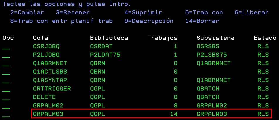

                        • sancho
                          • Mar 2015
                          • 300
                          #119
                          Hi Kos
                          proc.num was the first thing I tried.
                          I explain the problem,
                          I need, if possible, to obtain the number of jobs in a jobq, to test I am monitoring another jobq that usually has jobs:
                          In AS400 when working with the jobq with the wrkjobq qgpl/grpalm03 command It is noted that there are 14 jobs inside.
                          Click image for larger version  Name:	wrkjobq.jpg Views:	0 Size:	113.4 KB ID:	388245
                          Click image for larger version  Name:	wrkjobq2.jpg Views:	0 Size:	83.2 KB ID:	388246
                          If I create the item:
                          proc.num [,,"*SCD",GRPALM03]
                          It gives the following error:
                          com.ibm.as400.access.AS400Exception: GUI0052 * SCD is not valid for the active state. Without the * also gives error.
                          proc.num[F_LLEGADA,EVARGAS,,GRPALM03]
                          No error, but the value that itme gets is 0
                          I am doing something wrong??

                          • Kos
                            • Aug 2015
                            • 3453
                            #120
                            Hi sancho,
                            it seems that your jobs in the GRPALM03 subsystem are not in active state yet ("SCD" status on the job queue does mean: "This job will run as scheduled").
                            The proc.num[] metric uses the JobList class in API; so it allows to use as 3-rd parameter one of the following string constants (case-insensitive):
                            • *ACTIVE
                            • *JOBQ
                            • *OUTQ
                            • RUN (union of *ACTIVE and *JOBQ)
                            • ALL (union of *ACTIVE, *JOBQ and *OUTQ)
                            • any 4-character abbreviation for active job status in the table here.
                            So, when you try to use "*SCD" or just "SCD", it fails as it is not a valid state for an active job status.
                            Unfortunately, I'm not very good specialist in AS/400 systems; but I
                            supposed that the last case (proc.num[F_LLEGADA,EVARGAS,,GRPALM03], without 3-rd parameter at all) should work.
                            If you have only these 14 jobs in this subsystem, you can try to set the subsystem argument only:
                            proc.num[,,,GRPALM03]
                            Does it also return zero?
                            If yes, then, probably, we could not use this API "as is" (without modifications) for this purpose. Probably, it could be possible if we can specify a fully-qualified integrated file system name for a server job queue for this API call; but it will require an additional parameter for this metric.
