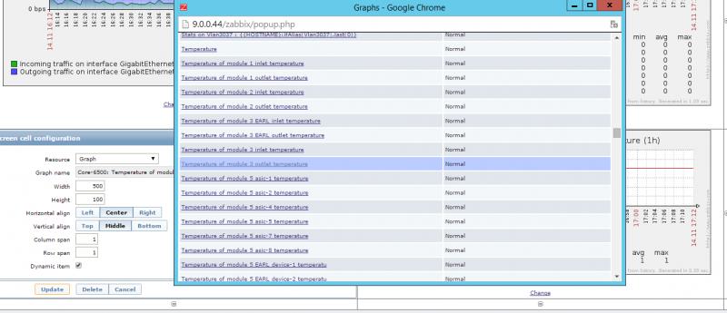

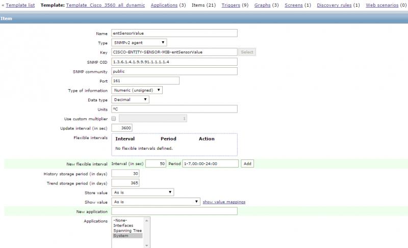

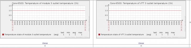

I`m new in Zabbix and currently I`m struggling with temperature graphs, I cannot make them to work.
The template I`m using is "Template_Cisco_3560_all_dynamic" and the item I`m using to get the data from is "entSensorValue" (pls correct me if I`m not using the "correct" language)
When creating a new screen and trying to add a new graph, for example "Temperature of module 3 outlet temperature", I`m getting a value of 1, always.
I`m attaching a few images to help you understand.
Many thanks !!!
