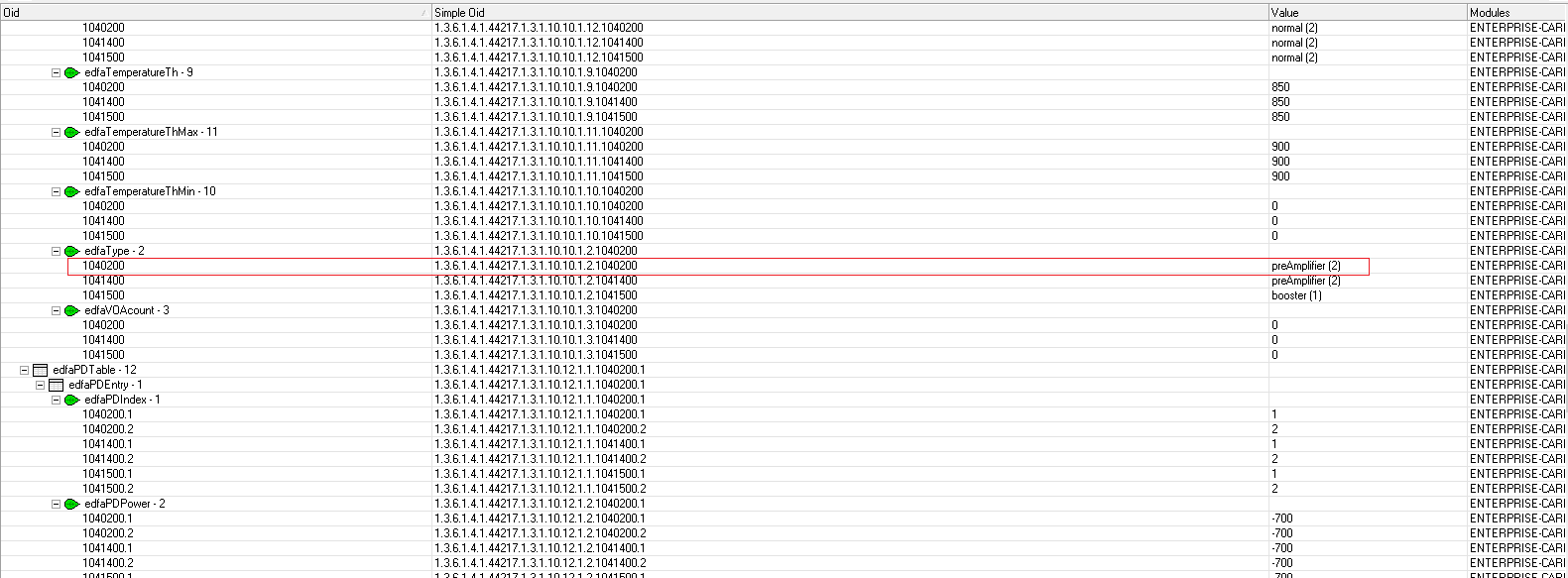

    3. the problem is as follows, the value is number as follows
    1 - preAmplifier
    2 - booster
    3 - lineAmplifier
    How would I be able to name these names? Now I only get the numeric value there
    my entry is now Card {#EDFATYPE} slot {#SNMPINDEX}
    But the result is "Card 2 slot 1040200", and correctly should be "Card booster slot 02"
    I tried it through value mappings. But it didn't help me, can you give me some type of way to deal with it?

    Hello
    I started to wreck the wreck, but I have a few uncertainties that I can't move.
    I started to create a template and there discovery
    SNMP OID - Discovery [{# EDFATYPE}, 1.3.6.1.4.1.44217.1.3.1.10.10.1.2]
    then i created an item that is at the end of the snmp OID
    1.3.6.1.4.1.44217.1.1.1.1.10.1.1. {#SNMPINDEX}
    I set macros in the name template
    {$ CARD.EDFA.EDFATYPE.MATCHES} => ^. * $
    I set up a filter on behalf of the discovery
    {#EDFATYPE} matches {$ CARD.EDFA.EDFATYPE.MATCHES}
    When I did it this way and I gave check now I got the necessary equipment as shown in the picture

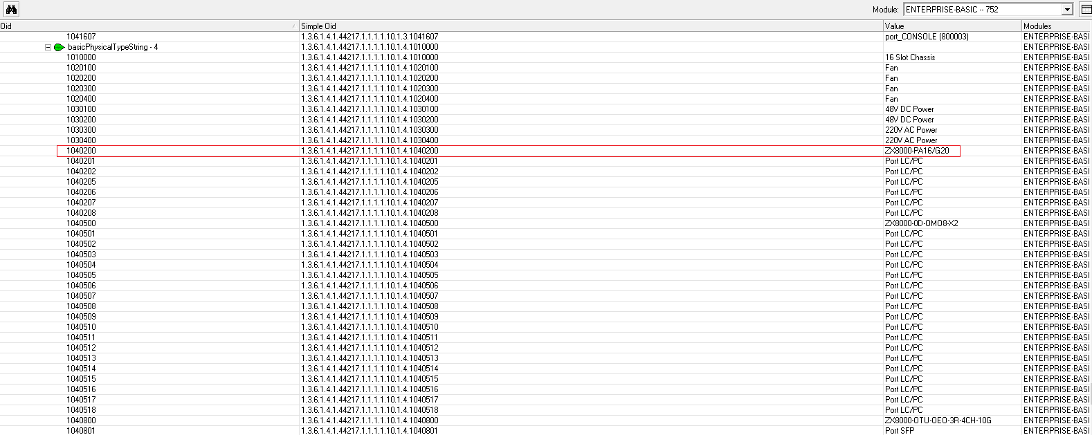

    The problem sets up if I want to define 2 items for discovery and set a filter there because I can't make dependencies between them.
    SNMP OID discovery [{# EDFATYPE}, 1.3.6.1.4.1.44217.1.3.1.10.10.1.2, {# CARDNAME}, 1.3.6.1.4.1.44217.1.1.1.1.10.1.4
    The problem is set by {#EDFATYPE}. these devices
    1040200
    1040500
    1041100
    image attached higher
    but {#CARDNAME} has many items.
    How to filter out that there are only 3 items that are only the first option?
