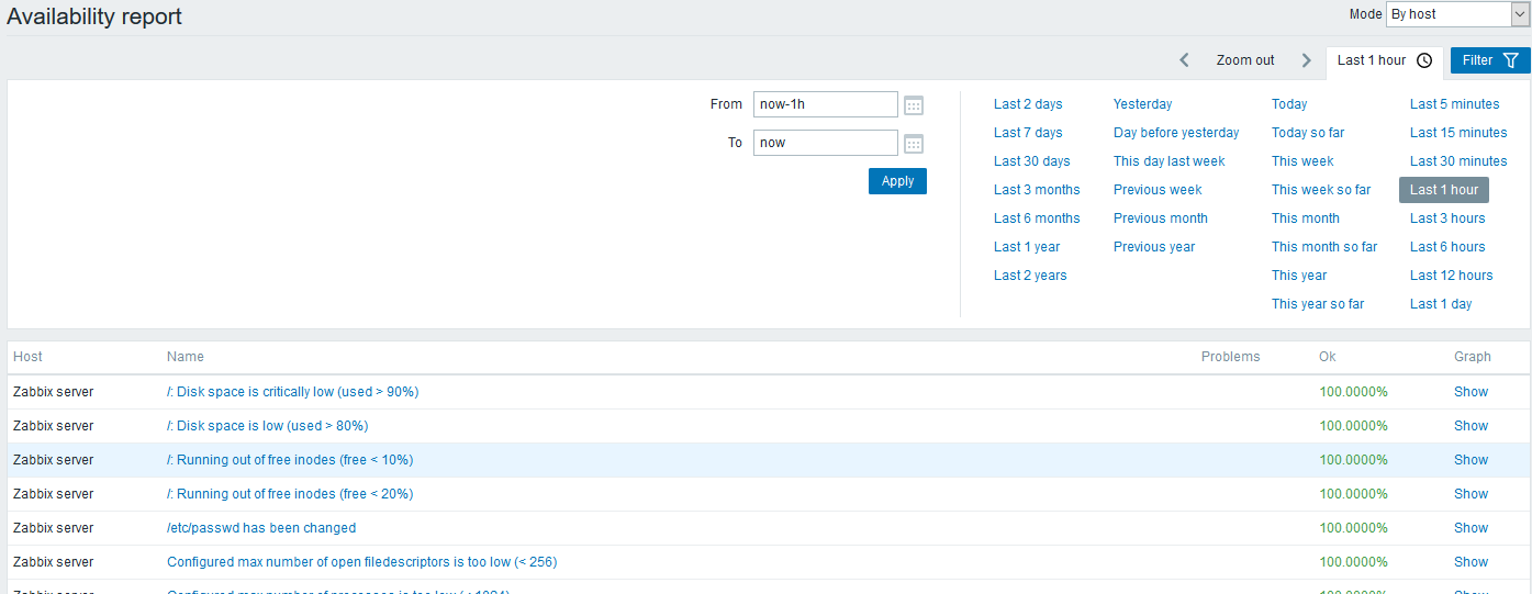

    What I see on the report page seems to be wrong!
    As you can see the disk usage is said to be >80% and >90%

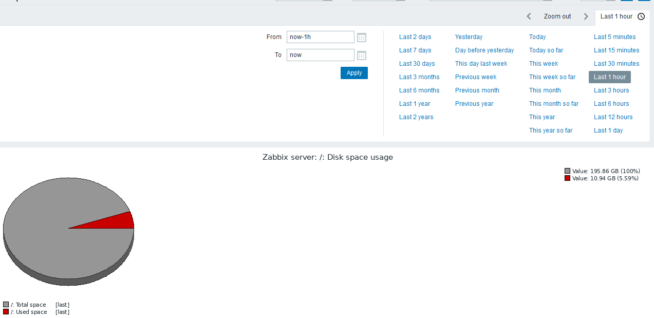

    But in the graph, I see everything to be normal.

    I don't use the template you appear to be using, but I think you're mis-reading what the report is saying.
    In the availability report you show, the "OK" column with 100% means that the trigger has not evaluated to a problem condition at any time during the reporting timeframe. The "/: Disk space is low (>80% used)" is only true when the trigger evaluates to a problem. As long as "OK" shows "100%", it means none of the configured triggers have detected any problems.
