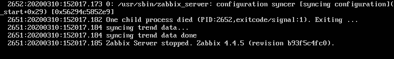

    My Zabbix Server keeps dying. I can restart it, but a couple of minutes later, I get this message:
    Any ideas??

    Try increasing the log level to see if the server logs additional information.
    Someone else that posted in the forums within the past few days was also having a problem with their syncer. For them, the reason was that they had modified their database schema incorrectly, while trying to fix issues with character set and collation.

      This is a Zabbix Appliance, and I have not touched the database. Now, I did edit the IP Address per these instructions: https://www.zabbix.com/documentation...nual/appliance

        So when I try to increase the log level, I get this message:
        zabbix_server [4360]: cannot open PID file [/var/run/zabbix/zabbix_server.pid]: [2] No such file or directory
