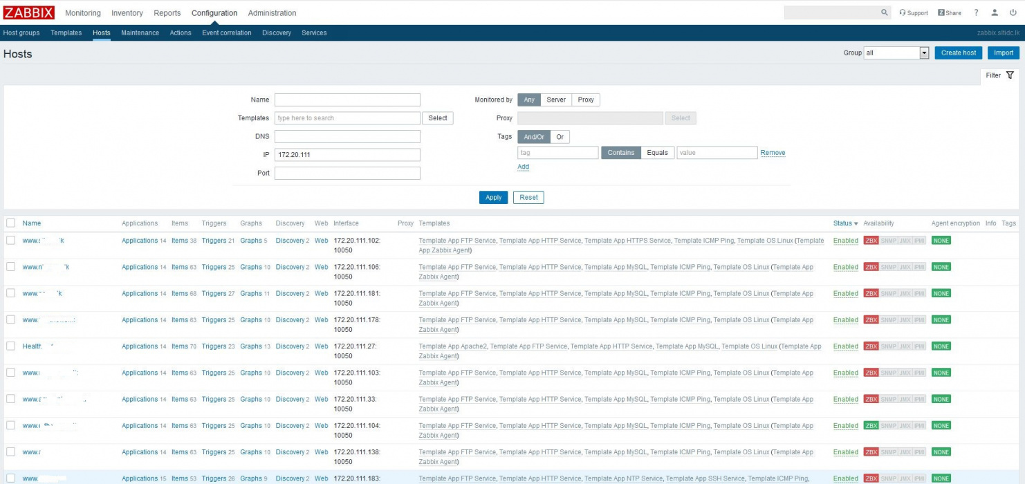

                Red "ZBX" in the host list means that passive agent connections are failing. From the short tcpdump output you can tell that there are both active and passive items for 172.20.111.102 (which is not a problem as such, just an observation).
