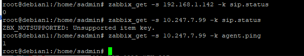

    I try to supervise a client using the zabbix agent and UserParameter.
    However, I have a problem.
    When I launch the command "zabbix_agentd -t key" on the customer, I get a good value.
    However, from the server, the command "zabbix_get -k key" returns to me "ZBX NOT SUPPORTED". Ditto for the web interface.
    I want to clarify that I have a client locally (on the same network as my server zabbix), and the whole thing works very well, I collect all the information I want.
    Thank you in advance for your help.

    Zabbix_get command :

    Check user permissions. Did you execute the zabbix_get command with the -t option specified as a user with special privileges, such as root? And is sip.status set by UserParameter executing a process that can only be obtained by such a user?
