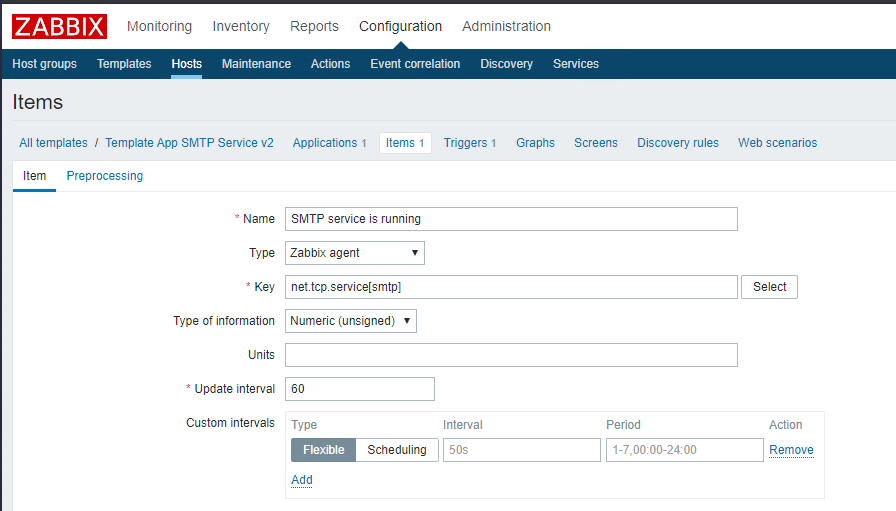

    Finally, found a fix.
    If this is the Zabbix default template for SMTP checks, then the check is a Zabbix "Simple check" which means that the check originates from the Zabbix Server.
    So a better test would be to check that you connect to port 25 from the Zabbix Server, rather than directly from the server being checked itself.
    Most likely, your Ubuntu server is running SMTP but that it might only be listening on the localhost interface for port 25, and not on an external facing interface. Or you have a firewall configured somewhere between the Zabbix Server and the Ubuntu server that is blocking the check from completing correctly.
    You can read more about Zabbix Simple Checks here: https://www.zabbix.com/documentation.../simple_checks
    source: https://www.reddit.com/r/zabbix/comm...t_smtp_status/
    I flipped it to Zabbix Agent and problem solved, is detectable now, see screenshot below:
