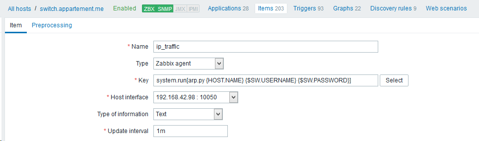

    My current solution is to use a Linux Server with the Zabbix agent. The agent execute a python script who connect to the switch, run the command, format the output and print a json.
    I'm currently using system.run to launch the script :

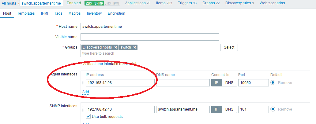

    It's working but there is a small issue : if I want to use system.run, I need to manually configure an agent interface with the IP of the remote server on each switch
Name:	Sans titre.png
    Is there any way to automatise this process ? I will have 100-150 switches to monitor at some point, it would be great if Zabbix could to it automaticaly
    If I'm not doing this correctly and there is a simpler solution, don't hesitate to correct me
    Thanks everyone !

    After some investigations, it's possible to use the API to add the switches with multiple interfaces. Ansible is able to do the trick
