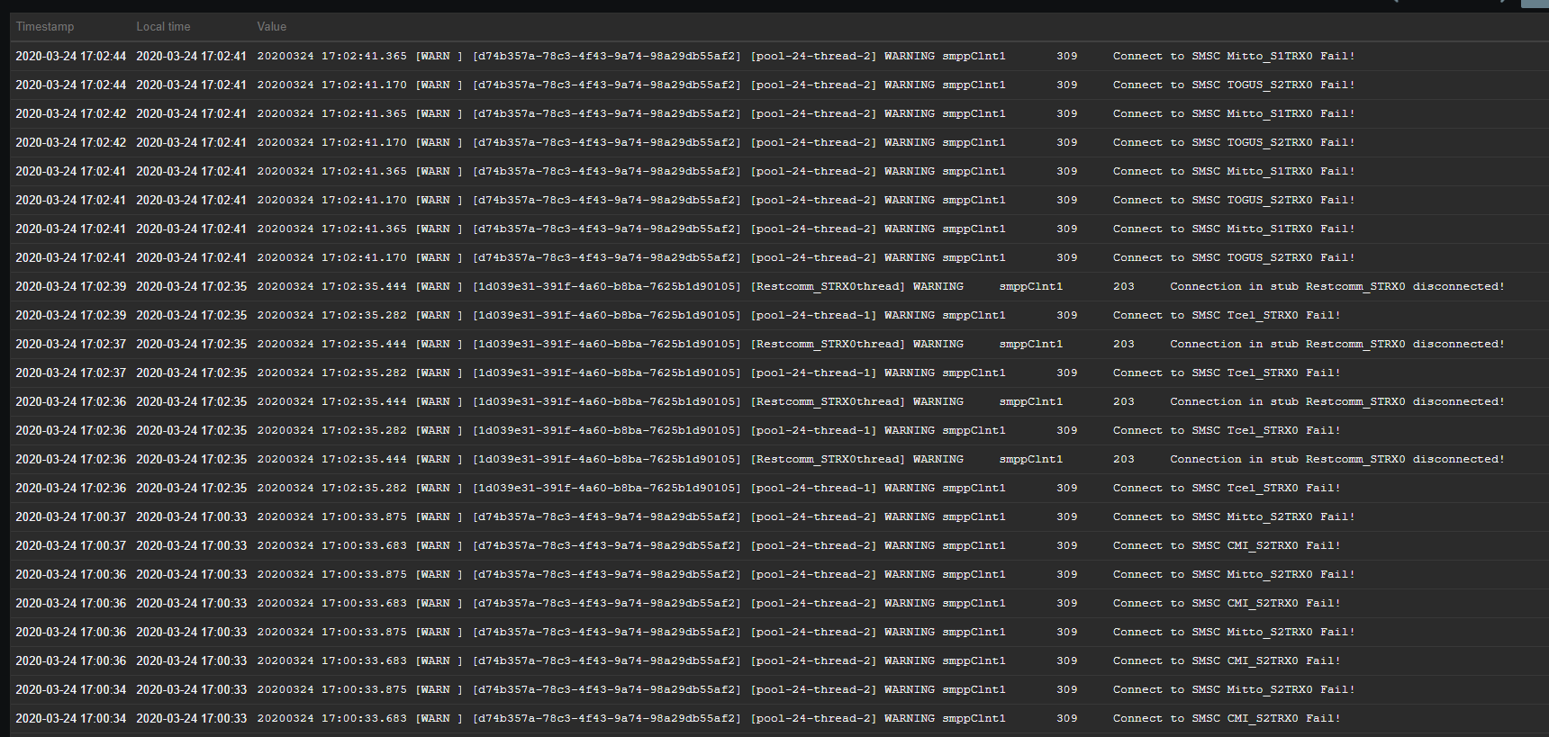

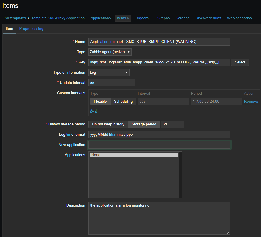

    I encountered a problem in log monitoring. I have item configuration to use logrt() function, that will monitor the application log. If the line of application log contain the key word "WARN", the log should be returned. Then I have defined some triggers to send alert notification.
    However I received multiple notification for a single problem event. Finally I disabled all triggers on this item, and monitor the latest date of it. I have noticed that the last few lines of problem event will be captured several times.

    item key: logrt["/k8s_log/smx_stub_smpp_client_1/log/SYSTEM.LOG","WARN",,,skip,,,]

    sometimes it happens that if you add skip aparameter to existing item key its not working - see documentation - eg. the skip paramter is ignored and the log is being reread from beginning every time

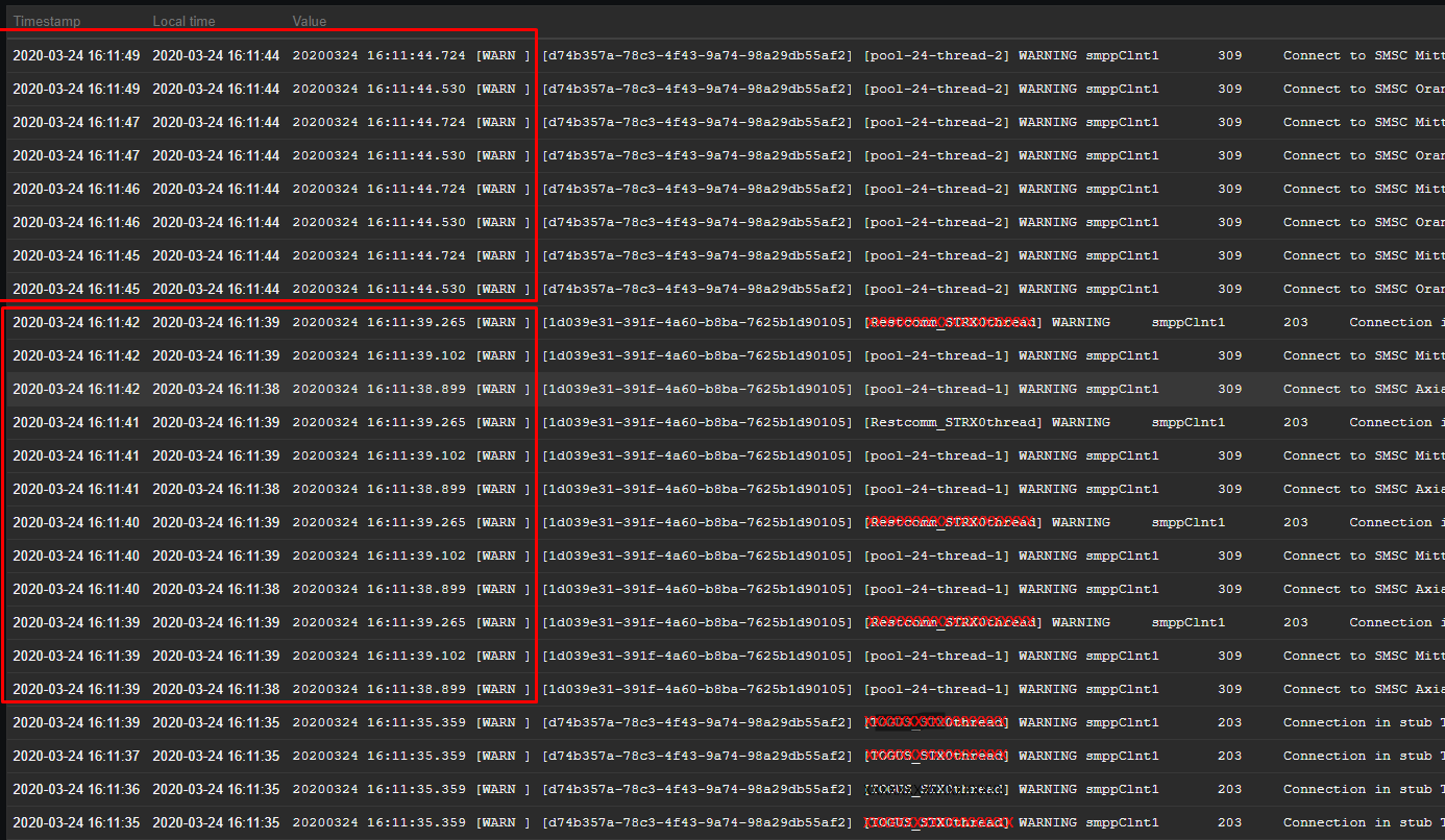

      Hi gofree,
      Thank you for your response. Here is the log and latest data screen capture.

        basically theye nor the same events in the log - so zabbix treats them as different events - they differ in the time section just before [WARN] string - in my opinion works as designed - zabbix is not priamrilly intended for logs if youd like to work with serious log monitoring go with ELK. In your case it seems that you have too frequent outages and zabbix cathes them all exatly as item and trigger have been configured.

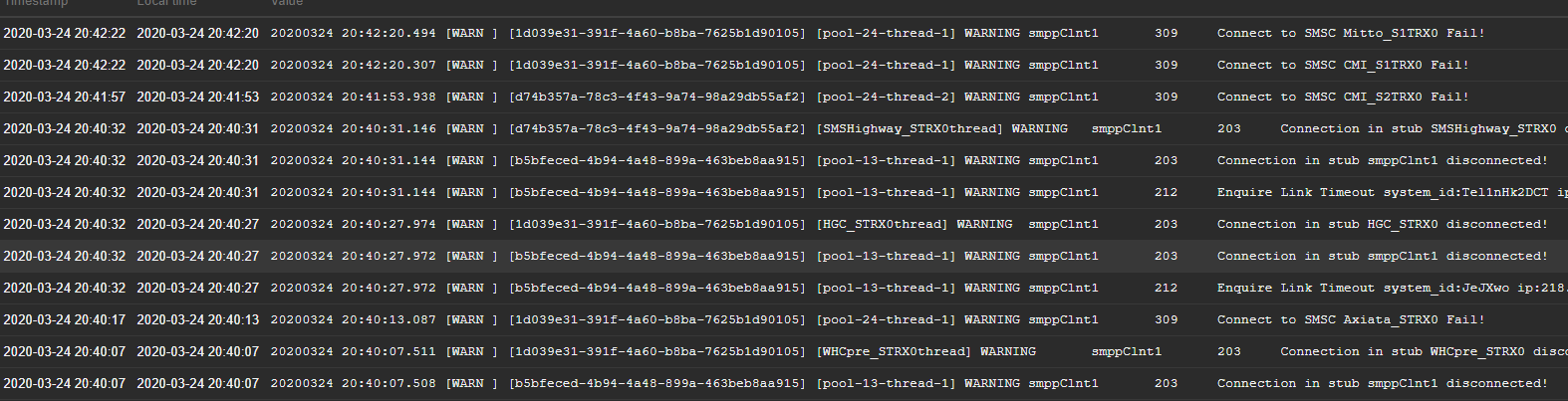

          Hi gofree,
          Finally, I found the problem in zabbix_agent.conf. It is the integration problem with K8s. In my deployment, the zabbix-server and zabbix-web are running as container in K8s. the zabbix-agent is running in host level.
          Previously, I have put all K8s master node's IP in agent config. Such zabbix-server received data from zabbix-agent 4 times.
          Now only one IP address is assigned to "ServerActive", the duplicated log event problem is solved.
          Thanks a lot!
          #ServerActive=10.10.50.11:33011,10.10.50.12:33011, 10.10.50.13:33011,10.10.50.14:33011
