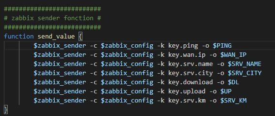

    Here's part of my code I use :
    What I am missing on zabbix_sender line ?
    I have nothing on server log file about this either... Any idea ?
    Thanks for your help !

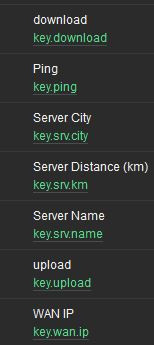

      The speedtest is set on Zabbix server right (M-monitor is the hostname of the serv) ! And key names are correct :
      Don't know what it could be..
      Thanks for your help !!

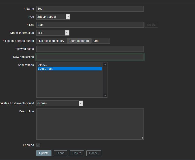

                I made a test like it's shown on doc :
                And then :
                Don't know what I do wrong.
