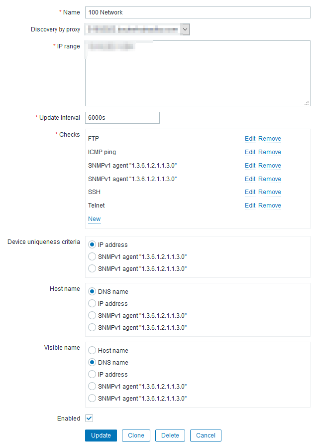

      Hope this is what you need?
      Discovery rule 200 Network:
      FTP <-- Port range 21
      ICMP ping
      SNMPv1 agent "1.3.6.1.2.1.1.3.0"
      SSH <-- Port range 22
      Telnet <-- Port range 23

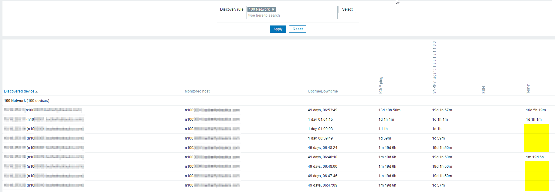

            Here we go.
            The discovery finds this:
            Click image for larger version  Name:	2020-04-24 17_59_11-Status of discovery.png Views:	0 Size:	46.4 KB ID:	400063
            The discovery is attached as file.
            The strange thing is that some are found (line 2 and Line 6) but some are not.

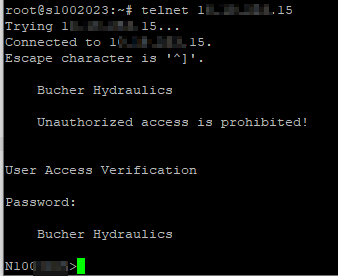

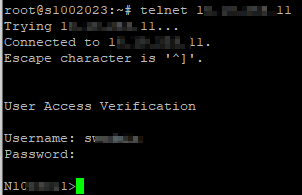

                What I now tried in addition is to connect to one device that works fine and I can see a difference.
                On the above you see a different order and it is not asking for a username, only for a password.
                The device that works asks for username and password.

                • Hamardaban
                  • May 2019
                  • 2714
                  Discovery uses net.tcp.service functionality....
                  Here https://www.zabbix.com/documentation..._check_details you can see:
                  “telnet Creates a TCP connection and expects a login prompt (':' at the end).
                  => no login prompt - no telnet detected.
                  You may use just tcp-on-23-port check...
