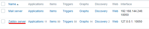

          Also on the console:
Name:	Zabbix Console.png
          Anyway, I deleted 'Mail server' from the console. Then I edited the mail server zabbix_agentd.conf and changed the hostname to Mailserver. I restarted the agent:
          [root@mail zabbix]# zabbix_agentd -t agent.hostname
          agent.hostname [s|Mailserver]
          and then added the server back into the console using the IP address (so no DNS questions) but I get the same result but with the new name:
          8170:20200413:135106.517 cannot send list of active checks to "192.168.144.246 ": host [Mailserver] not found
          So the space isn't the issue.

                  Thanks.
                  • provels
                    • Apr 2020
                    • 93
                    You see the jobs running on both boxes and can ping by name and IP and telnet between them on 10050 and 10051? If no, maybe try a hosts file. No firewalls installed by default on these, right? That's about all I got.
