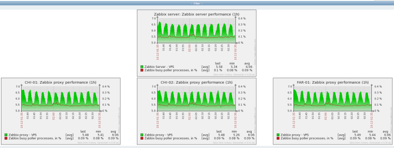

    Setting up a new Zabbix 2.2.7 environment with 1 server + 3 proxies.
    All on RHEL6. Server uses Postgres 9.3, proxies are sqlite.
    All agents in this test environment are handled by ONE proxy (CHI-01)
    We also have 80 hosts, that are just being pinged, also by proxy CHI-01.
    >> The other 2 proxies are just sitting idle <<

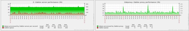

    When i look at the performance graphs, it looks as if the server and the 3 proxies are all doing the exact same thing.
    In the attached screenshot the server is on top, with 3 proxies feeding into it.
    Is this normal behaviour ?

      To collect the actual graphs, the data from proxy have to be collect by him.
      For example, CHI-01 proxy has to be monitored by CHI-01 proxy,
      FAR-01 proxy has to be monitored by FAR-01 proxy, etc.

        I have completely stopped the "FAR-01" proxy server an hour ago, and the graph is still populating the same metrics as the others..
        Looks like all PROXY self-monitoring graphs get their data from the SERVER metrics ?

          Do you mind to show us the screenshot of your Host configuration screen?
          I mean, the list with Names, where we can see, which Proxy are using for monitoring servers & proxy.
          My part of screenshot is attached.
          Also I attached the part of summary screen where you can see two different graphs.
          Sincerely yours,
          Aleksey

            The proxy should be monitored by the agent that is installed *ON* the same system.
            I had the agents pointing to the Zabbix server first..
            All's good now
