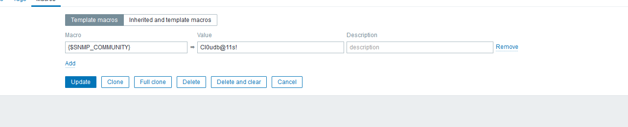

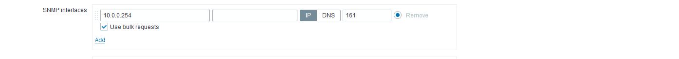

    • james.shaw
      • Mar 2020
      • 15
      SNMP isn't agent based, it's network based. Most IoT devices allow SNMP nowadays, if you can set it up, you would then apply it to your template/host as Macro as far as I am aware. As I have never heard of Tasmota, I wouldn't be able to assist on that part. I currently monitor my WG firewall at home through my internal network and the SNMP community value is something you would setup on the Device.
      I am still quite new to Zabbix myself, so maybe someone else with more experience would be better placed to assist you, but I am sure setting up the correct trigger over SNMP should work.
