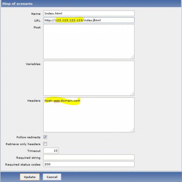

        Thats awesome, sounds like exactly what I was looking for!
        I'm kind of new in the whole networking field, but could anyone tell me what I'm doing wrong?
        In the Headers field of the Web Scenario step I added the following:
        "Host: www.domain.com" 123.123.123.123
        Is this right? Because for whatever reason, it seems to ignore the IP address part and simply checks domain.com from its origin, and that is not what I need.
        I tried adding this header either to the Web Scenario 'Scenario' tab or into the 'Step' section, but it came back with the same results.

            See attached image.
