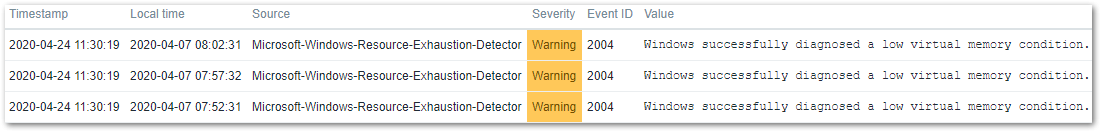

Name:	2020-04-28 18_16_50-History [refreshed every 30 sec.] and 5 more pages - Work - Microsoft​ Edge.png
    What I would like to setup is a trigger if the event is logged, but only log this once since this event can fire continuously.

    At the moment, each server is reporting the same error multiple times.
    Is the problem expression correct? I'm not filtering the data, since I'm doing that in the item.
