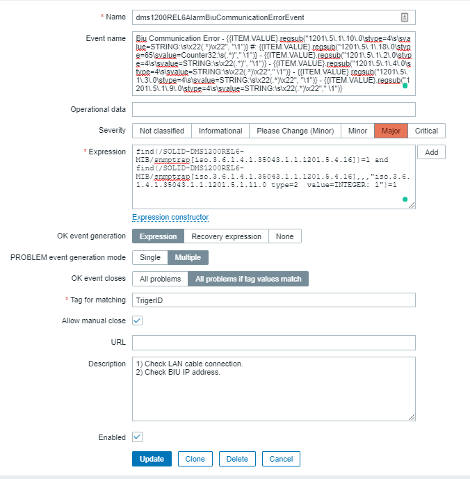

          HI ,
          I have worked it out. I uase a regexes to extract the ID for example Tag Name =TrigerID and Value = {{ITEM.VALUE}.regsub("1201\.5\.1\.18\.0\stype=65\s value=Counter32:\s(.*)"," \1")}.
          Then in the trigger I look for both the trap OID and the statement that that says it is active for example expression = find(/SOLID-DMS1200REL6-MIB/snmptrap[iso.3.6.1.4.1.35043.1.1.1201.5.4.16])=1 and find(/SOLID-DMS1200REL6-MIB/snmptrap[iso.3.6.1.4.1.35043.1.1.1201.5.4.16],,,"iso.3.6.1.4.1.35043.1.1.1201.5.1.11.0 type=2 value=INTEGER: 1")=1
          Th
          iso.3.6.1.4.1.35043.1.1.1201.5.4.16],,,"iso.3.6.1.4.1.35043.1.1.1201.5.1.11.0 type=2 value=INTEGER: 1 is what i am looking for to say that it is active when it recvoers it is iso.3.6.1.4.1.35043.1.1.1201.5.4.16],,,"iso.3.6.1.4.1.35043.1.1.1201.5.1.11.0 type=2 value=INTEGER: 0 .
          Now if you set it to
          OK event generation = Expression
          Ok evernt close = All problems if tage valuse match
          Tag for matching = TrigerID
          It will fire when it gets 1 and resolve if it gets a 0
          I also add a bunch of regexes to name the event from data from the trap here is what i use in the Event name:
          {{ITEM.VALUE}.regsub("1201\.5\.1\.10\.0\stype=4\s\ svalue=STRING:\s\x22(.*)\x22", "\1")} #: {{ITEM.VALUE}.regsub("1201\.5\.1\.18\.0\stype=65\s value=Counter32:\s(.*)"," \1")} - {{ITEM.VALUE}.regsub("1201\.5\.1\.2\.0\stype=4\s\s value=STRING:\s\x22(.*)", "\1")} - {{ITEM.VALUE}.regsub("1201\.5\.1\.4\.0\stype=4\s\s value=STRING:\s\x22(.*)\x22"," \1")} - {{ITEM.VALUE}.regsub("1201\.5\.1\.3\.0\stype=4\s\s value=STRING:\s\x22(.*)\x22", "\1")} - {{ITEM.VALUE}.regsub("1201\.5\.1\.9\.0\stype=4\s\s value=STRING:\s\x22(.*)\x22"," \1")}
          Here are the screenshots.
          Reach out if you need further help
          BTW this is on ver 5.4
