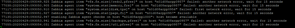

    I upgraded from 4.4.7 to 4.4.8 yesterday - A very short time after that, I started getting timeout errors for my AIX servers.
    They are up and down - they will be unresponsive for a few minutes, then they will come back again.
    I checked the Zabbix logs and saw the standard timeout errors - there have been absolutely no firewall changes and this is only effecting AIX;

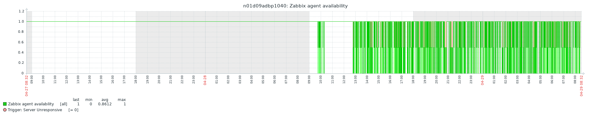

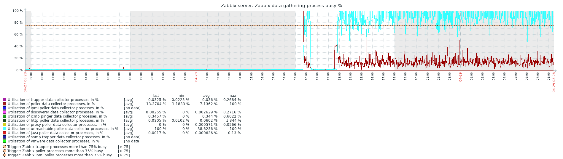

    The timing is exactly when I upgraded Zabbix to 4.4.8 - ever since then, you can see the availability of the AIX agents is up and down, along with the associated data gathering processes;

    We're on AIX 7.1 - the agent we're running on them is 3.4.0. I actually went ahead and upgraded the agent to version 4.2.1 on some of them - it's made no difference.

    For additional clarity, as soon as I disable all the AIX servers from monitoring, the processes go back to normal;
