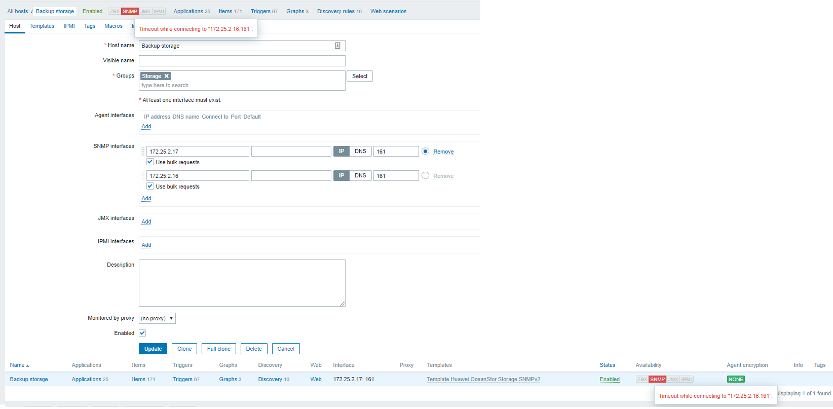

i have host (storage) with two controllers (because redundancy), in host settings i created two interfaces (two IP adresses) - i noticed that one interface should be identified as default, i reading data via snmpv3.
How it works in zabbix when default interface is DOWN ? if im correct it should switch to secondary interface and read data from it, actually when it happens instead of switch to secondary interface, host just saying that there is timeout while connecting to interface (it is the default one).
While this situation im not recieving data for graphs, is there way how configure switchover of interfaces ? f.e. if one interface is down it will swiftly begin use the secondary interface and read data ?

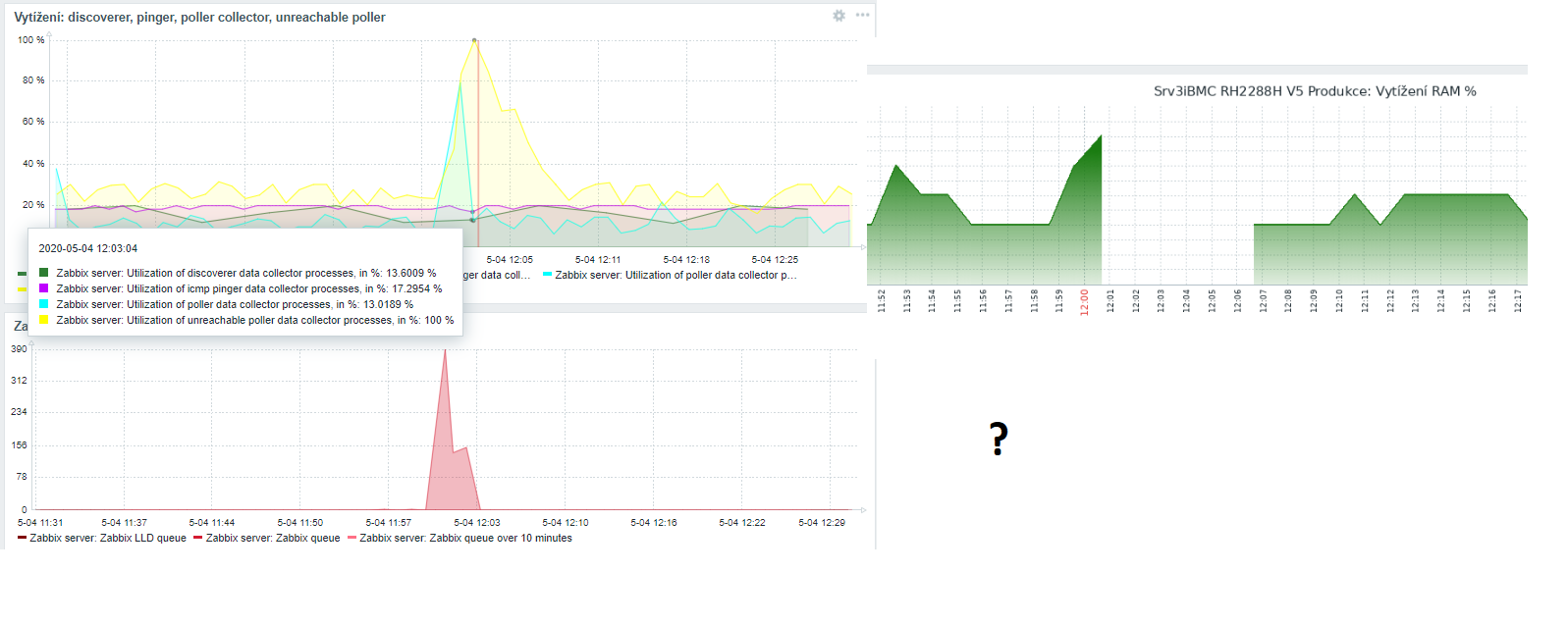

Together with this behaving and i thing that is caused by symptomps wrote above, sometimes the unreachable pollers and poller collectors suddenly raise their load to maximum and zabbix queue also suddenly raise - am i correct that reason is that coulnd be interface for snmp reading is down and because zabbix cant reach it ?
