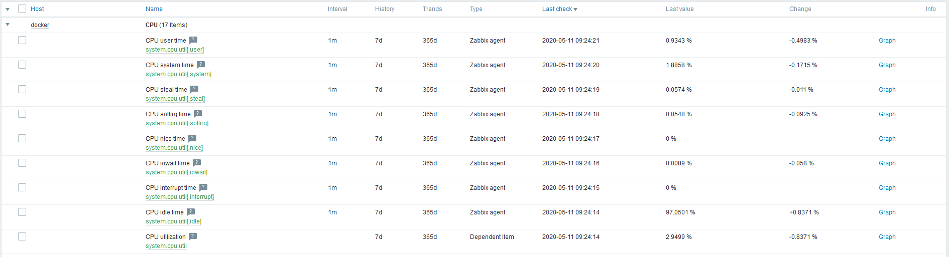

    Incoming data from agents is one hour "too late" (its around 8:24 and it shows 9:24)

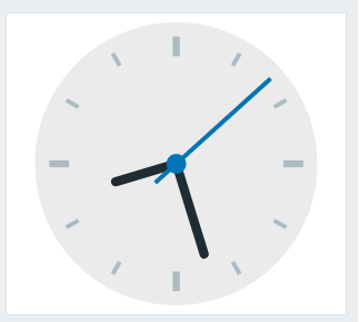

    The clock on the main page shows correct time though

    I tried changing the timezone in php.ini file to the correct one but it didn't help, perhaps there is something else that needs to be configured?

    Check the time / time zone on the agent.
    • dawidp
      dawidp commented
      It is correct
      admin@docker:~$ date
      pon, 11 maj 2020, 12:13:02 CEST
      admin@docker:~$ timedatectl | grep "Time zone"
      Time zone: Europe/Warsaw (CEST, +0200)
