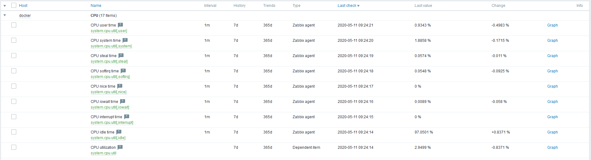

    Incoming data from agents is one hour "too late" (its around 8:24 and it shows 9:24)

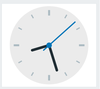

    The clock on the main page shows correct time though

    I tried changing the timezone in php.ini file to the correct one but it didn't help, perhaps there is something else that needs to be configured?
    I also tried checking the time/timezone on the agents with date and timedatectl | grep "Time zone" and they do show correct time also.
  • Geoclimate
    • Aug 2020
    try to use my solution
    1.
    Change time zone
    cp /usr/share/zoneinfo/Europe/Warsaw /etc/localtime
    2.
    find file zabbix.conf
    find / -name zabbix.conf
    3.
    edit file zabbix.conf
    (in my case) /etc/php-fpm.d/zabbix.conf
    vi /etc/php-fpm.d/zabbix.conf
    find inside
    php_value[date.timezone] = Europe/Warsaw
