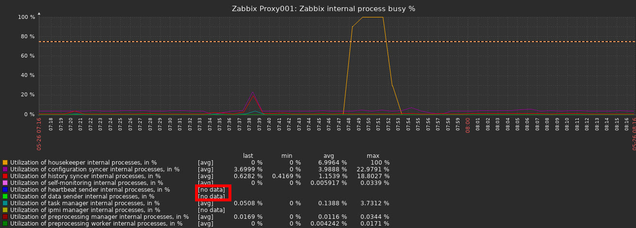

      • karanpreetsingh1990
        • Apr 2020
        • 16
        Originally posted by aib
        Please, check "data_sender" process. It is the process which sending data from Proxy to main server and mark for delete records in local DB. If data_sender cannot send data to main server, data are sitting in local DB.
        I assume that your proxy collecting so much data that it cannot be send to main DB before receiving new data.
        Or your connection between local proxy and main server is very slow.
        Check graph "Internal process busy" from template Zabbix Proxy.
        I checked the internal process busy in the graph but I see no data being reported for that.

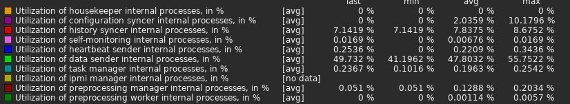

            • Apr 2020
            • 16
            I made the change to the zabbix agent on the server and the Host configuration on the UI and can now see the details on the graph. Thanks a lot for that trick!!
            I see that the Data Sender is around 50% utilized on average. Could this be causing the issues?
Name:	5-26-2020 8-30-28 PM.jpg
            Also, How could I get that utilization down? Any settings on the Server side that could help me get this resolved?
            Regards,
            Karan
