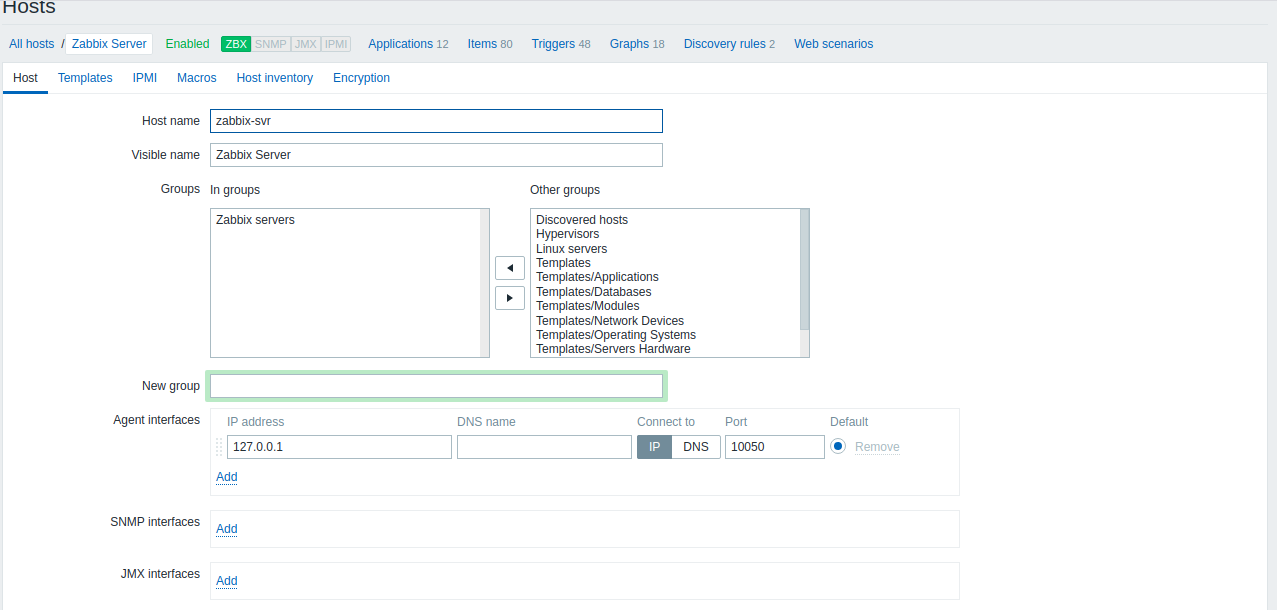

    I am trying to publish metric to Zabbix server using Zabbix sender.
    I am on Zabbix 3.4
    The command I am running is as follows:
    zabbix_sender -vv -z zabbix-svr -s "zabbix-svr" -k db.connections1 -o 43
    This is the result:
    zabbix_sender [15607]: DEBUG: answer [{"response":"success","info":"processed: 0; failed: 1; total: 1; seconds spent: 0.000028"}]
    info from server: "processed: 0; failed: 1; total: 1; seconds spent: 0.000028"
    sent: 1; skipped: 0; total: 1
    Also Attaching screenshot of how my host is configured in the zabbix gui
    Click image for larger version  Name:	Zabbix Hosts.png Views:	1 Size:	64.2 KB ID:	401312
    Not sure where I am going wrong.

    Can you show how the 'db.connections1' item is configured on zabbix-svr ?
    BTW, 3.4 isn't receiving software updates any longer, so when you have a convenient opportunity, you should consider upgrading to a recent long-term support (LTS) release.
