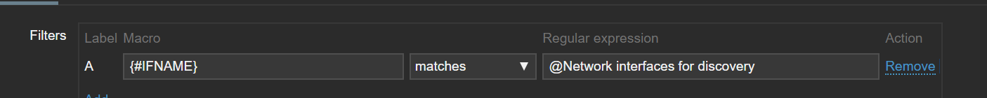

    You can use a filter which needs to be true for the item to be created.
    Would that be a workaround?
    Only create the items (with trigger) that are needed for triggers?
    Otherwise you can make a template with 2 items.
    1 with a trigger and 1 without.
    I don't want items for these interfaces, so I use that expression in Filter
    Network interfaces for discovery
    1 » ^pflog [Result is FALSE]
    2 » ^pfsync [Result is FALSE]
    3 » ^enc [Result is FALSE]
    4 » ppp [Result is FALSE]
    5 » pptp [Result is FALSE]
    6 » ^dummy [Result is FALSE]
    7 » ^lo [Result is FALSE]
    8 » ^bond [Result is FALSE]
    9 » ^Software Loopback Interface [Result is FALSE]
