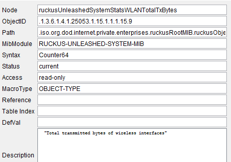

    I'm monitoring Ruckus R510 unleashed device with 200.6 fw (the same appears on 200.8 and others see this too example).
    Traffic counters are received as counter64 and returns pentabytes per minute.

    10:23:01 (20 ms) : Custom OID .1.3.6.1.4.1.25053.1.15.1.1.1.15.9.0
    10:23:01 (31 ms) : SNMP Datatype: ASN_APP_COUNTER64

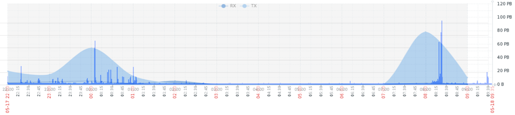

    Thus zabbix obtains the same data, graphs look similar to what is shown on the device management page, but scale is completely screwed. Here curved lines are taken from the device, spike line is taken from zabbix
    Zabbix peak arount 8:00 is 100+ Pb, ruckus web page reported max value of 127.58Mb.
