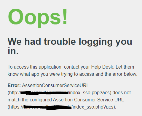

This information is copied from Duo's Application webpage where this information is generated. Clicking update and trying to login gives the below error.
Now, as far as I know all is good with the Duo setup. This is a Duo error but as you can see the AssertionConsumerServiceURL has sent an HTTP link and Duo is expecting a HTTPS link. I can't change Duo to expect a HTTP as it only support HTTPS requests, so my question is can I alter that in Zabbix so that it sends it via HTTPs and not via HTTP?
