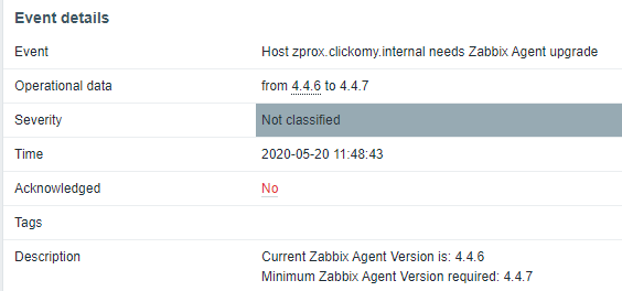

      Thank you Hamardaban for the reply. This is exactly the approach I eventually took, with just a slight change: Instead or returning 0/1, I return either "UPDATED" or the version number. This way, I'm able to create trigger when the value is not "UPDATED", and then use the value returned as an information for the notification.
      The real challenge, really, was to check if "a.b.c" is lower than "x.y.z" ; none of which are comparable values, and this is where the JScript preprocessing came into play
      This is the final result when checking Zabbix agent version:
      Click image for larger version  Name:	Untitled.png Views:	0 Size:	15.1 KB ID:	401542
