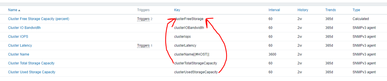

    I'm working on a template that is for Netgear ReadyNAS OS 4 and want to calculate the result from two items, one is getting total disk size (volumeSize) and one is getting free disk space (volumeFreeSpace). So I tried to create a new item that is doing the calculation.
    Formula:
    last("volumeFreeSpace")/last("volumeSize")
    But when I'm running the test I get this:
    • Cannot evaluate function "last()": item "Template SNMP ReadyNAS RAIDAR:volumeFreeSpace" does not exist.
    My plan is to based on the results create a trigger that notify me if it exceeds e.g. 20%
    I'm aware that this is an easy task but I'm just a beginner and need some help to get the basics.

Name:	calculated freestorage.PNG
Name:	calculated freestorage - sources.PNG
    Sincerely yours,
    Aleksey

      Thanks Aleksey,
      Now I get it
