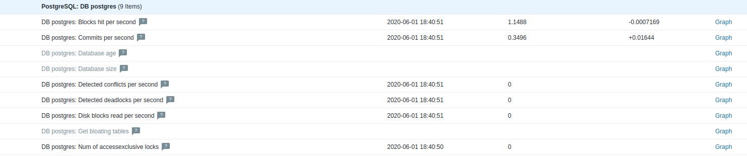

    Currently I am trying to set up postgres monitoring with the latest new agent2.
    I have manage to get most of the data but except for pgsql.db.bloating_tables, pgsql.db.size & pgsql.db.age.
    I am getting this error code "Cannoe Etabilish Connection To Postgres Server: Failed To Connect To `Host=Localhost User=Postgres Database=Postgres`: Server Error (FATAL: Password Authentication Failed For User "Postgres" (SQLSTATE 28P01))."
    I have configured the postgres username and password in agent 2 configuration.

      I also realized that while the Postgres instance stats are connected via the credentials in the agent2.conf, the stats that collect the discovered databases actually use the host level macros, similar to the mysql agent2 template.
      While I am all for this for the sake of keeping things consistent, why the duplicity of needing to specify it in two places in the first place?
      Hopefully thats helpful for you kcteh as the screenshot looks like it may reflect this, where its pulling from the host (inherited) macros for pg.user and pg.pass, rather than the config file.

          Yes.
          In the Zabbix front end, head to configuration -> host.
          From there, select your host with the postgres agent2 template applied.
          Then go to the Macros sub-menu.
          Flip the switch to Inherited and Host Macros
          Find the macros for {$PG.USER} and {$PG.PASSWORD}, and click change to the right of them, and set your value in there.
          You can set the value as text (readable in the frontend) or secret text (obfuscated in the front end).
          FWIW, {$PG.URI} also looks to be used, however if you are only talking to an instance on the host that the agent is running on, there's no need to set this.
          All of these variables are how the new MySQL agent2 template is configured, in case you run into that.
          Hope this helps kcteh

            You are awesome reedacus25 ,
            I have manage to get the data once I have set up the macros in the front end.
            You are amazing and thanks for your quick responses and helped. Appreciate mate.
            Note to others,
            Just to make some correction in my previous post #4, actually you don't need to set up .pgpass and pg_hba.conf.
            Just have to follow reedacus25 in post #5 you will be able to do it.
