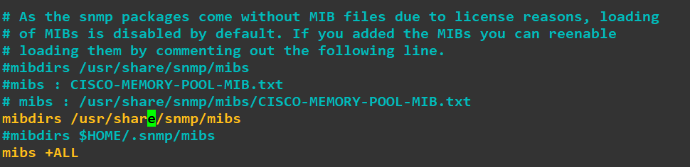

      Thank you for your time. What i have now.

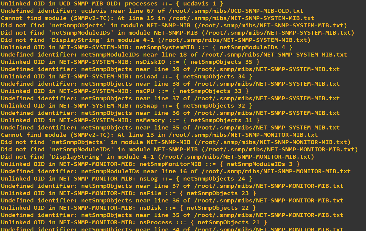

          And how I understand if i make command ->
          snmptranslate -IR -On SNMPv2-MIB::sysDescr.0
          I should get an imromation but i have errors:
          It is veru strange path where it try to find information (/root/.snmp...) I have another path in snmp config -> usr/share/snmp/mibs
          • puz27
            • May 2020
            Hello! I solved my problem! I copied all cisco mibs that i had to -> /home/user/snmp/mibs All Good! Thank you!
