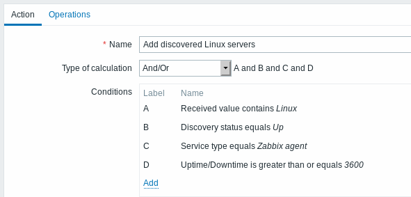

    I'm trying to follow the article to automate system discovery. While following the article the screenshots do not match what I'm seeing at all. Can someone tell me what I'm missing?
    https://www.zabbix.com/documentation...discovery/rule
    I'm stuck on step 2. I don't see anything even resembling the screenshot.

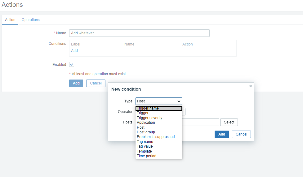

    From Online Documentation From my server

    I'm still hoping someone can please tell me what I'm doing wrong here. The instructions are not clear.
    How do I make this RULE? Please.

      • Hamardaban
        • May 2019
        • 2714
        A listing of existing actions with their details is displayed. The actions displayed are actions assigned to the selected event source (trigger, discovery, autoregistration actions).
        https://www.zabbix.com/documentation...ration/actions
        You are shown options for the "trigger" source . Select the source -
        discovery.

        It seems that none of the Discovery or Autoregistration conditions are there.
        https://www.zabbix.com/documentation...ion/conditions
        Is there a secret to showing them? Do I need a permission?
        • ComputerHabit
          • Jun 2020
          • 46
          I finally found it. Hey Zabbix documentation control Draw a freaking arrow where to go!!!! Took me so long to notice that field.

          • Hamardaban
            Hamardaban commented
            You didn't specify the version you are using. In version 4, the interface part was different, but the principle is the same.
          • zoldmaster
            zoldmaster commented
            OMG Thank you. I registered here just to say so. I've been poking at the web interface for 2 days now trying to figure out why "Create action" wasn't working like the documentation!
          • 4985
          in version 4, its right upper corner
