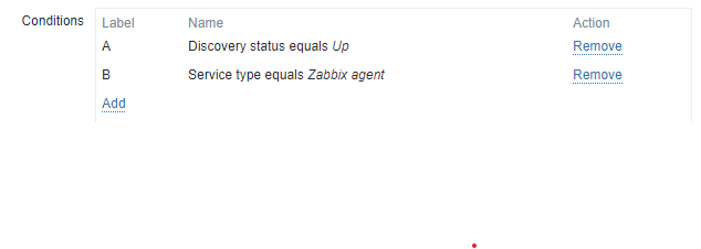

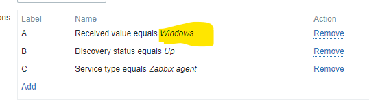

    I have verified that the directions on this page are incorrect.
    https://www.zabbix.com/documentation...discovery/rule
    When I create a rule as exhibited in the link above discovery fails to execute.
    Works Fails (From Documentation)
Name:	Annotation 2020-06-08 142132.png
ID:	402934 Click image for larger version
Name:	Annotation 2020-06-08 142054.png
    • ComputerHabit
      • Jun 2020
      • 46
      Okay I realized that I was using "EQUALS" and not "LIKE" in my evaluation.
