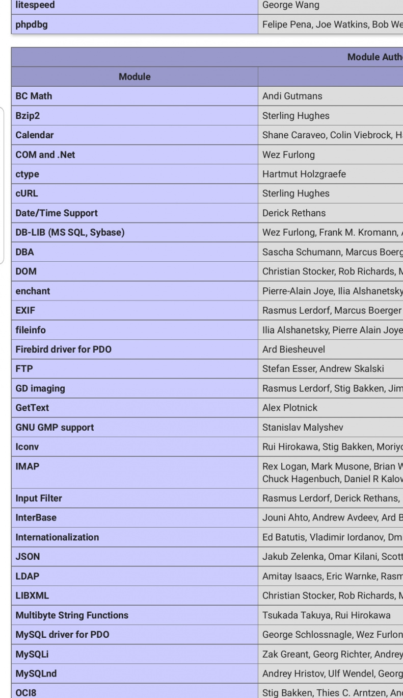

        I had some error during upgrade database, so I solved it manually, some columns, indexes etc, didn't exist in tables, so I've created them manually. After that, upgrade finished, and server started.
        My version of php-mysql is:
        Desired=Unknown/Install/Remove/Purge/Hold
        | Status=Not/Inst/Conf-files/Unpacked/halF-conf/Half-inst/trig-aWait/Trig-pend
        |/ Err?=(none)/Reinst-required (Status,Err: uppercase=bad)
        ||/ Name Version Architecture Description
        ii php-mysql 2:7.3+69 all MySQL module for PHP [default]
        This is output from php version:
        Click image for larger version  Name:	ApEFbO3.png Views:	0 Size:	9.3 KB ID:	403617

          Does Debian separate the PHP ctype code into a separate package? It would probably be called something like 'php-ctype' or similar. If it does, you need to install that too.
          • coudy
            • Mar 2012
            • 17
            I've checked that. Ctype is in php-commom, and I've that package installed.
            root@nas:~# LC_ALL=C apt-cache search ctype | grep php
            php7.3-common - documentation, examples and common module for PHP
            php7.4-common - documentation, examples and common module for PHP
            php-symfony-polyfill-ctype - Symfony polyfill for ctype functions
            root@nas:~# LC_ALL=C apt install php7.3-common
            Reading package lists... Done
            Building dependency tree
            Reading state information... Done
            php7.3-common is already the newest version (7.3.15-3).
            php7.3-common set to manually installed.
            0 upgraded, 0 newly installed, 0 to remove and 41 not upgraded.
            root@nas:~#
            And loaded in modules too
