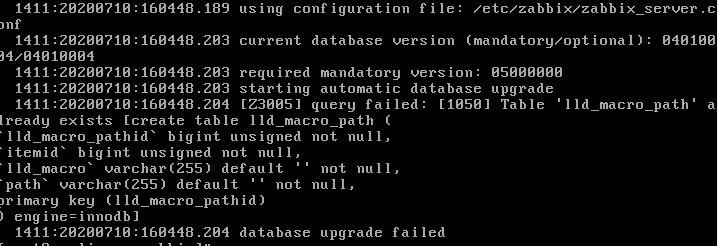

            LOG
Name:	Annotation 2020-07-10 170525.jpg

              Have you restarted zabbix_serverd on the 5.x appliance? Are there any database-related messages in the log?
              • dave08
                • Jan 2020
                • 29
                Originally posted by tim.mooney
                That shouldn't make any difference.
                Thanks for the reply.
                Of course I did. It even rebooted.
                "table already created". I think I'll have to drop the database, create it again instead of restoring directly...
