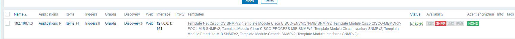

        I must be the thickest person on the planet ! - Somehow I have been able to add the switch , however it doesn't appear to be giving me any data - So no cpu/memory/interfaces etc The graphs option is greyed out.

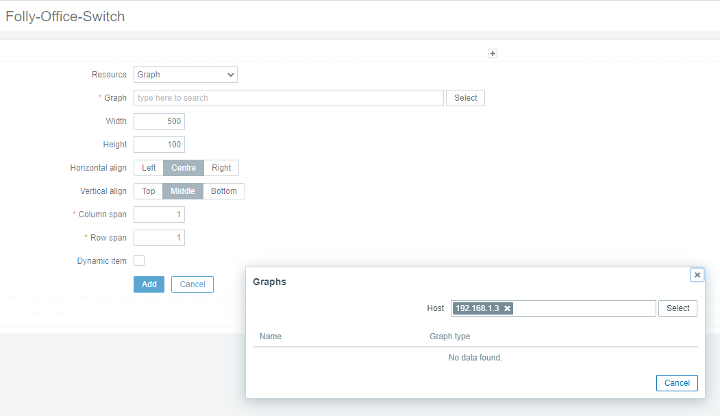

        I cannot create any Screens either

          Please, correct IP address for SNMP interface.
          From your screenshots I assume that host name is "192.168.1.3" , but SNMP interface for requests is 127.0.0.1 port 161
