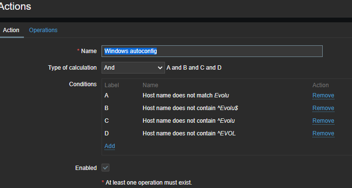

      I created the rule in action -> autoregistration
      but hosts are still registered.
      is the Rule incorrect?
      I want to accept self-registration except hosts that match the rule.

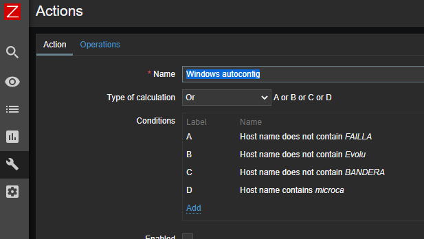

          When you add other conditions, they are ignored.

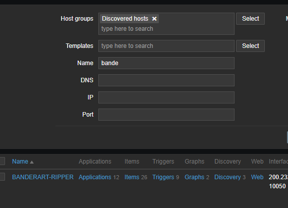

          BUG?
          I tested with "and" and "OR"
          **Zabbix Server 5.0.1

              Hi, this is working for me on 4.2...
              Please post a screenshot of the edit page of the action.
              Regards
              Gert

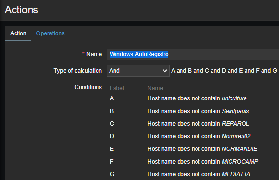

              • solution
                • Jun 2020
                • 272
                The rules are as follows:
                I would like to ignore the hosts self-registration that contains the words from the list above.
                But when I activate the rule, everyone is registered including those I want to ignore.
                Details:
                ** 1 Rule with more than one word
                1) Type of calculation:
                AND, OR, AND / OR
                Status: register all, ignore list
                ** 1 separate rule for each word
                ** 1 single rule with only one word:
                Status: ignore OK / Rule applied
                • gert.derouck
                  • Jan 2020
                  • 69
                  With this rule any machine will autoregister...
                  -> Should be "A and B and C and D"
                  Then it will register machines that contain "microca" and do not contain any other of the listed strings.

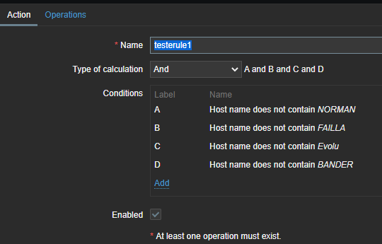

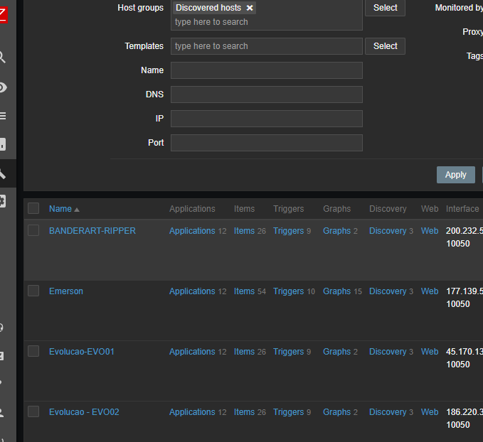

                      • solution
                        • Jun 2020
                        • 272
                        It's like I mentioned before, with AND or OR, the rule is not applied

                        • gert.derouck
                          • Jan 2020
                          • 69

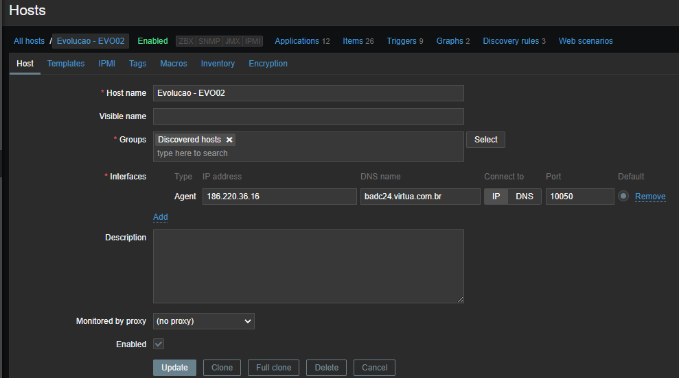

                          Maybe a stupid question, but did you remove these hosts first?
                          Can you also post a screenshot of the details of eg Evolucao - EVO02? What is the hostname of that machine?
                          • solution
                            • Jun 2020
                            • 272
                            Yes, I deleted and updated the page and checked the log.
                            And then I activated the rule.
                            print detail host:

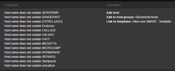

                            • solution
                              • Jun 2020
                              • 272
                              #15
                              Thank you for your help.
                              The problem was just doing the following:
                              1) Port 10051 closed on the Firewall (to block agents)
                              2) Template Unlink and Clear on Hosts
                              3) Exclude Hosts
                              4) Recreated the conditions in Autoregistration -> Actions
                              5) Reboot Server
                              6) After Reboot Discovery Hosts Check (No new host)
                              7) Zabbix Queue check (no hosts excluded)
                              8) Open port 10051 on the Firewall.
                              Status:
                              Hosts that contain one of the terms defined in "conditions": Are ignored
                              Other Hosts: Are registered
                              Action --> Conditions Final:
                              Thanks a lot for the help.
