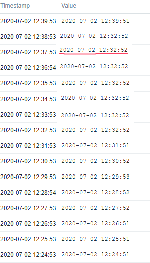

    SQL Server provide from query to Zabbix value in text of date and time of last replication when was done, its updating every minute like this:
    ​s
    What i want to achive is when the updated value will be this same for 5 updates interval it will start Trigger, like here:
    Click image for larger version  Name:	asdas.PNG Views:	3 Size:	4.7 KB ID:	404446

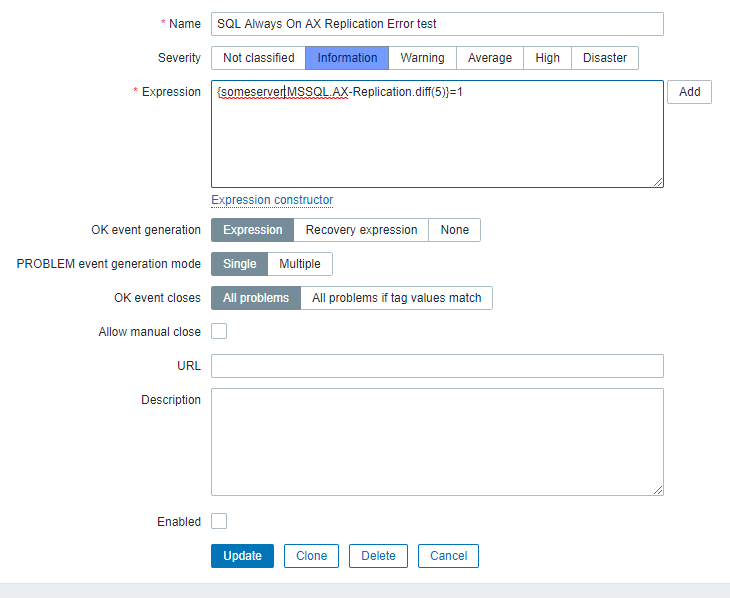

    I've created a Trigger with this settings:
    Click image for larger version  Name:	image1.png Views:	2 Size:	28.4 KB ID:	404447
    But eventiualy is sending problem all the time, can someone help me with this situation ?

    First: the diff function does not have parameters.
    Due to the fact that the value you have in the form of text, you can not apply many trigger functions...
    Try the expression "last()=last(#1) and last (#1)=last(#2) and last(#2)=last(#3) " and so on....
