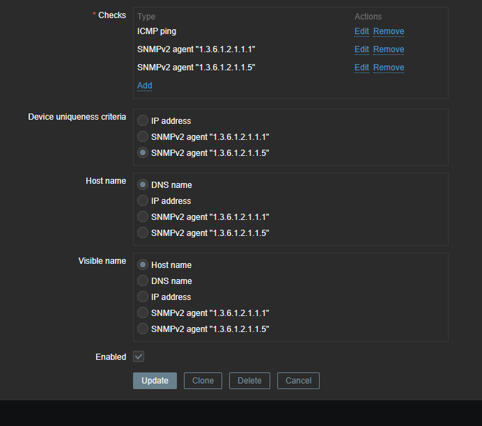

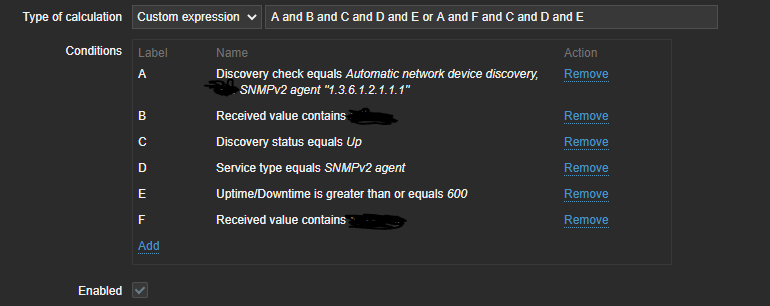

            • Mike2K
              • Oct 2018
              • 60
              Could you show us your discovery rule ?
              • skym
                • Jun 2020
                • 23
                Discovery Rule:
                Discovery action:
                • Noobz
                  Noobz commented
                  What happens if you change the type of calculation to simple "and" instead of custom?
                • skym
                  skym commented
                  That does absolutely nothing.
                • Noobz
                  Noobz commented
                  Ok just wondering as I have basically the same discovery rule, doing the same checks and applying the same actions. Only difference is that mine is just an AND rule, thought it may be some kind of bug with the way the custom rule was processed.

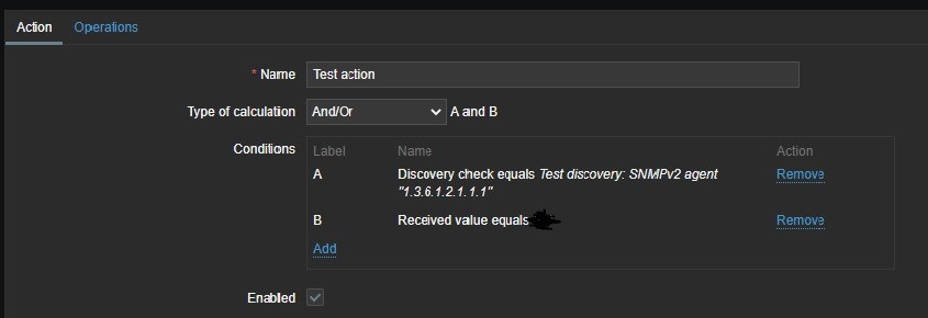

                      I already have a kind of a test action, as it's supposed to send me an email, but there's nothing in action log for the past day nor have I gotten an email.

                          Test Action:
