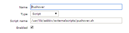

    Hello Community:
    Have set up notifications via PushOver using https://github.com/twostairs/zabbix-...pt/tree/master but nothing appears to happen when an issue arises. I have tried specifying the full path to the script as per attached image. If I execute the script from the command line all works well. What am I missing please ?
    Thank you.
