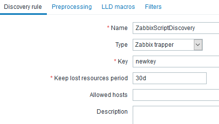

    this is my setup at the moment:
    zabbix_sender -z localhost -s "zabbix_script" -k newkey -o '{"data":[{"{#KEYNAME}":"SipRejectCause499"}]}'
    Response from "localhost:10051": "processed: 1; failed: 0; total: 1; seconds spent: 0.000236"

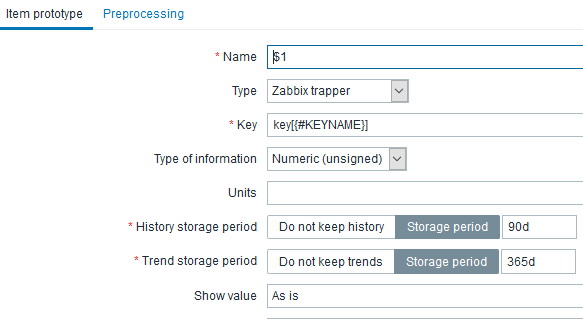

    will result in:

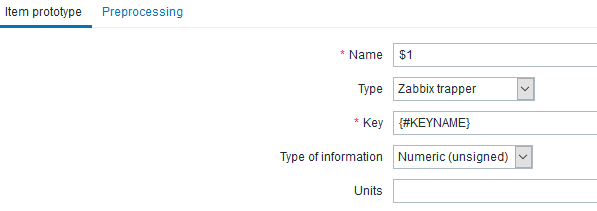

    so the name is perfect, but i would like to get rid of: " key[ ] " to archive something like this:
    is there any chance i can solve this with the discovery-function?

      What happens if you change your Item Prototype so that instead of Key: key[{#KEYNAME}] you instead try Key: {#KEYNAME}
      Does that accomplish what you want?

        i have tried
        {#KEYNAME}
        [{#KEYNAME}]
        [#KEYNAME]
        all with the same result.

          To get what you want (as in pictures) in field “key“ in item prototype just use lld macro {#KEYNAME}.

            this is the config which will lead to the error in post #4:
            btw, i am using Zabbix 4.4.5. on a RedHat OS
            • Hamardaban
              • May 2019
              • 2714
              I saw that you tried to use the proposed syntax and wrote that it is correct, and not some other.
              Try do not use $1 as the name of the data item prototype. Specify the macro and some text explicitly.
