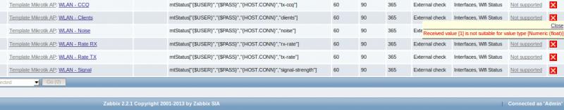

    Im having a problem with a external check. My script returns all tha values correctly, without problems. But zabbix shows me a error to each item.
    An Example: Received value [1] is not suitable for value type [Numeric (float)]
    in case, i think "1" is a Numeric(Float). But Zabbix doesn't thinks the same.
    Follow a print from error in attachment.
    Can someone help me?
