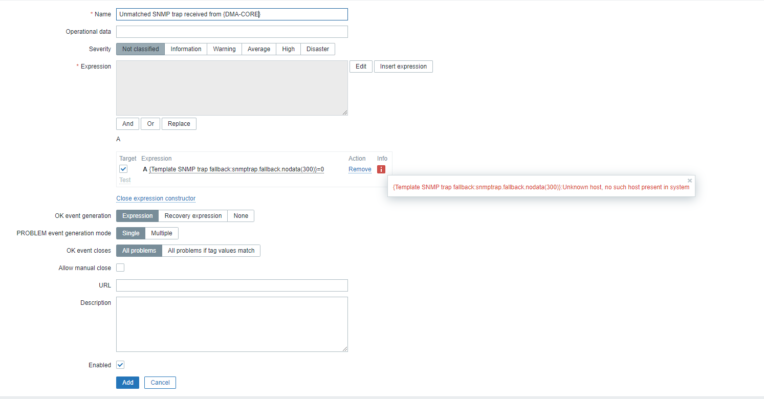

    Hello everyone ,
    I tried to configure a SNMP TRAP for the first time , i created a template «Template SNMP trap fallback» and the item . but when trying to configure the Trigger , i got the error in th screen attached
    ====> {Template SNMP trap fallback:snmptrap.fallback.nodata(300)}:Unknown host, no such host present in system
    Can someone please help me ? it's a little urgent and thanks in adavnce

    Hi, my advice is to follow official zabbix blog on SNMP traps here: https://blog.zabbix.com/snmp-traps-in-zabbix/8210/
    If you get stuck on any step - try to write back here so we can help. From the post above it's not clear what you have and have not already set up on your server/proxy.

      Hello , Thanks for your reply ! the issue is solved , it was due to the template's name . i changed corrrectly and now it's working fine .
